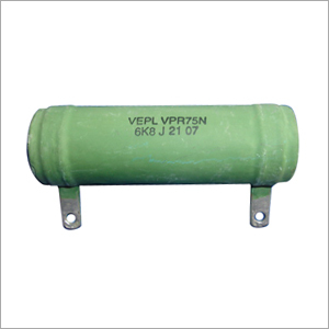

And there are massive/powerful wirewound ones that are green in colour and you can see the wound wire on the substrate! But they are quite dangerous ... exposed wire, who wants some of that?
Usually they look like that
But ...
sometimes they come like that

... But they are quite dangerous ... exposed wire, who wants some of that?
Most resistors have exposed wires... Big ones no different than your standard 1/4W PCB resistors  ;D
And you want to shield them from unintended touching anyway, these things can get hot, very hot.
Operating temperature range up to 225 degrees (TE range), much hotter during short term overload condition.
You don't want people to touch that by accident.

The conductivity is a problem if it is mounted in a metal clamp and it gets hot, which then causes a leakage to the clamp of the resistor voltage. It is possible to have enough current flow to make it go into thermal runaway.
