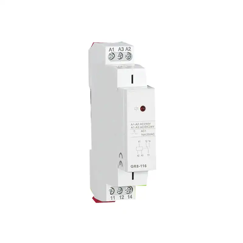

I prefer not to expose cheap modules to mains switching and instead just use them as the control interface to a better industrial DIN rail relay and let them do the real work.
Examples:
Offline Psi
