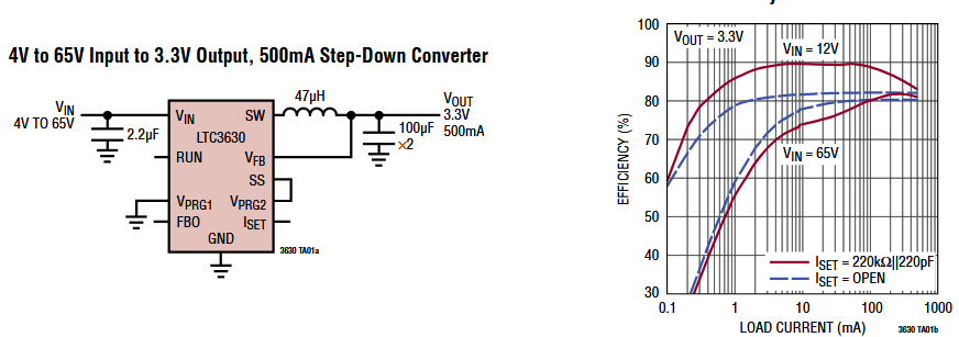

now you have min 75v DC in, 60v out at 20mA ... you can use a switching regulator to convert 60v to 3.3v
If budget is not an issue, a 9$ (in 1qty) LTC3630 would fit the requirements : chip, inductor, couple ceramic resistors and capacitors and you're good to go. over 80% efficient with 65v in , 3.3v out at 100mA+
Link : https://www.digikey.com/product-detail/en/linear-technology-analog-devices/LTC3630IMSE-TRPBF/LTC3630IMSE-TRPBFCT-ND/8566932
Something cheaper at 4$ would be LM5166 : https://www.digikey.com/product-detail/en/texas-instruments/LM5166YDRCR/296-47663-6-ND/8133067
As the switching frequency is lower (~200kHz with such high voltage) , you'd need bigger inductor... also a bit less efficient , a bit over 70% efficient at 65v in - > 3.3v out
and others you can easily find with some filters on a distributor like Digikey...
The big issue you're gonna have is HEAT ... the microchip part being a linear regulator, it will throw away the excess as heat.
For example, if you design with an input capacitor big enough to have minimum 75v at 20mA but your product actually consumes much less than 1w, the input capacitor will go up close to your high voltage because it never discharges completely.
Let's say your product uses 150mA at 3.3v (0.33 watts) and these are converted with 80% efficiency by the switching regulator  ... that means 0.41 watts were taken from LDO.
0.41w / 60 = 0.006875 A ... let's just round to 7mA
So you may have an average of 120v DC at the input, and 60v on the output ... that means the regulator will dissipate  (120v - 60v) x 0.007A = 0.42 watts ... this will raise the temperature of the LDO by around 50 degrees, so the chip will be around 70-80c hot  ... datasheet says 80c/w thermal resistance... if placed on pcb with plenty of copper that drops a bit but still...
Still, you'll cook that 1uF..4.7uF electrolytic on the input...
Ideally you really want to decide on a maximum power that's lower, like let's say absolute maximum 200mA at 3.3v
