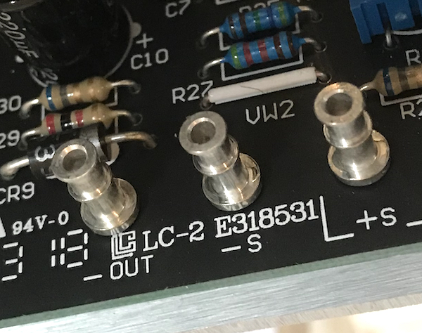

I just bought an International Power IHBAA-40W linear power supply, and need to connect wires to the output posts:
Are these posts designed to be soldered to? Or is there some slicker way to connect wires to them?

Soldering could unsolder the posts from the board, if it's not done with a lot of care.
How about wire wrap? If done properly, it can be more reliable than solder.

I think those things are called turned terminals and are supposed to be soldered. There is no corresponding female connector.
And I'm not sure what to do about desoldering from the PCB, but if you google "turned terminals", you will find manufacturers of those things, I bet they have recommendations.
EDIT: Although Harwin has this text on their page "Turreted lugs available in 1, 2 and 3 wirewrap level versions.". So this implies that upper part is for wire wrap. But that seems strange without special tools.

The terminals may be press fit+soldered, or even rivetted+soldered - so soldering may not be that difficult for the average person.
A picture of the track side of the PCB should reveal more.

Those look like solder turrets, in which case they’re designed to be soldered to. This video explains it:
https://youtu.be/Mrhg5A1a1mU
The only thing that’s odd is that they’re hollow. Is it a 2-2.6mm or 4mm hole? If so, maybe they’re intended to accept banana or mini-banana plugs.
No, that would imply that the lower part, invisible in this picture, is for wire wrap. (But this is practically guaranteed to not be a wire wrap version.)

Those are turret solder terminals.  Solder your wires to them as shown in the video posted by tooki.
They are NOT wire-wrap terminals.  ALL wire-wrap terminals have SQUARE posts.
The square edges are needed to bite into the wire in order to make a secure connection.

These post are designed for soldering wires to them and were pretty common. Heating the post up will not cause it to fall off because it is peened, riveted, or swaged, so it is firmly fixed on the circuit board. After being swaged to the board with the solder pad underneath which makes a good mechanical connection, the swaged head of the post is soldered to the pad to insure a good electrical connection as well.
As the video shows, the wire you want to connect is bent around the top or the bottom turret and is soldered in place. Here is a cross section of the way the posts are fixed to the circuit board.
Oh, and some of the hollow posts were used to insert a component lead up through the hollow post and the short end of the lead was bent over to hold it in place while it was being soldered. The photo I just took shows one of these from the backside of the board. The lead that goes into the hole in the metal post is the connection as there is no pad or run on this board.
Thanks! I remember watching the Pace soldering series a long time ago, but the details must have since slipped away.
They're not deep enough to hold onto a plug -- more like shallow indentations.

I have several open frame linear power supplies with these posts.  Without exception, they are soldered.  On one, wire was inserted to the top hole and soldered.  On the other, wire was weaved amount 3 terminals and soldered.  On third, wire was soldered on side, rather poorly.
