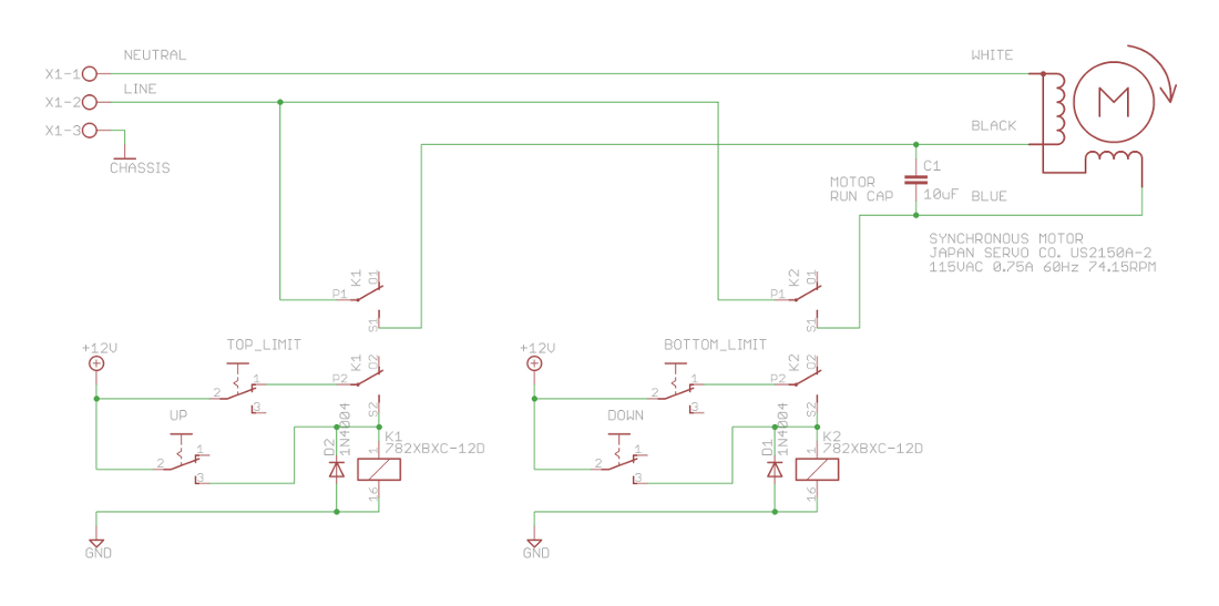

Hello -- My daughter is doing an invention fair project in which she aims to create a simple analog device that can magnetically attach to the exterior of a dishwasher and that will contain a light indicating when the dishwasher has been run. This light will go on when the surface temperature of the dishwasher reaches a minimum temperature and then must remain on until it is manually reset (eg, whenever someone comes along to empty the dishwasher).
She has found a small surface mount disc thermostat that closes on rise (normally open) at 85 fahrenheit (https://www.alliedelec.com/product/selco/ca-85/70098628/) that seems like it would provide a good temperature sensor. The only problem is that it has auto-reset, meaning it will re-open once the temperature drops back to normal again. She can't find anything equivalent to this that has manual reset. Of course, if she uses an auto-reset switch, then the light will go off as soon as the temperature of the dishwasher drops back down, which basically makes her gadget pointless.
Is there a way to set up the circuit in such a way that would allow the light to stay on (with manual reset) even after the temperature drops (and the temperature-sensing switch goes back to open)? Is this where a "relay" would come in?

A simple latching circuit will work.  The simplest concept is a relay that, when it closes, shorts the thermostat with one of its contacts.  To reset, break that short with a pushbutton or whatever.  For simplicity, have the relay coil the same voltage as the lamp that indicates the machine has run.

I endorse the LM555 approach. But since I have a schematic sitting around which demonstrates a latching relay configuration, I'll include that.
The functional block at bottom left shows a DPDT relay (a coil plus two sets of switched contacts). The disc thermostat would connect in place of the "UP" pushbutton, applying power to the relay when the thermostat closes. Once energized, the relay supplies itself with power until the connection is reset using a normally-closed pushbutton ("TOP_LIMIT"). The application in the schematic, a motorized lift, uses the second set of relay contacts to switch the load; but if the indicator light is connected in parallel with the relay coil, a single-pole relay could be used as well.
As others have observed, this approach would quickly exhaust a set of batteries. A wall transformer or other continuous supply of power would be needed.
« Last Edit: February 12, 2020, 07:32:35 pm by reboots »
