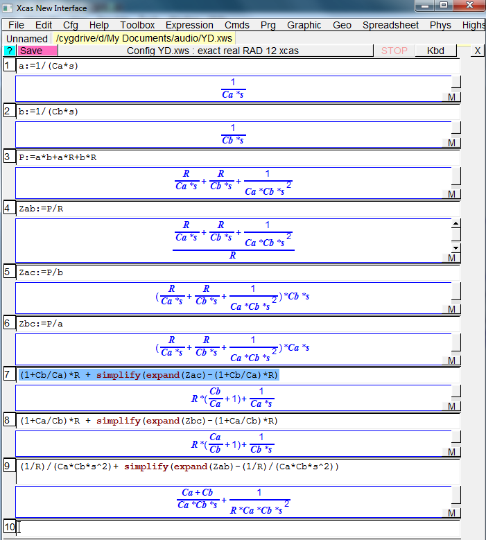

yes hope they don't expect anyone in 2015 to the algebra by hand
I've used symbolic math solvers for this for the past 1/4 century
do you have any of Maple, Mathcad, Mathematica?
otherwise you could try one of the free CAS such as the XCAS or wxMaxima, Sage Math project...
but you do need to know how to setup the nodal system equations and most CAS will require hand manipulation to get the form of the equation expected
