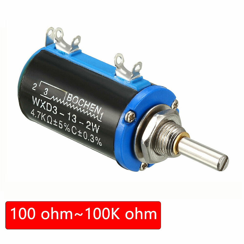

u3 voltages are as follows,this is with the output set at 6v in cv mode pin1:-5.2v pin2:0.0002v pin3:10.05v
pin4:-5.12v pin5:-5.22 pin6:22.61v pin7:23.69v pin8:0.2v,pin 3 doesent vary smoothly with the cc pot but
sits at 10v cc led off,0v led on,its like on or off,no smoth varyation but a sudden jump,hope this helps.

CC setpoint at U3 pin 3 should smoothly go from 0.005V to 1.5V as you rotate the pot. Using values P2 10k, R17 33R, R18 56k. You are getting 10V which is way too high.
Either the potentiometer P2 is defective or wired up wrong, or R18 or R17 are the wrong value.

well sorted it,it was the pot u/s,replaced it and its working fine,cheers all m3vuv.

What sort of Pot is it? I have had 2 cheap 10T Pots from ebay do the same thing. Real scary when it's the CV Pot.

Anyway the supplied pots in the kit are crap. One was faulty at start and the other failed soon after.
Yes I finally got this Kit to work properly by reducing the transformer voltage to 20 Volts.  Also replace the pots with  WXD3-13-2W 10K 10 Turn Potentiometer .

My failed Pots are fake Bourns 3590S series,10K via ebay. The resistance wire breaks.
There are a lot of Bochen WXD3-12 Pots about. I hope they are not fakes.
Looks like they are 5 turns which I think I can live with.
