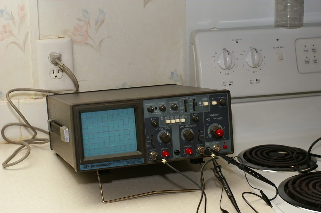

Offline elliott
  • Posts: 175
Re: Cheap Oscilloscope
« Reply #8 on: September 01, 2011, 02:09:47 am »
Check your local classifieds, I just picked up an old BK Precision 2120 that I found on Craigslist. It looks brand new and came in the original box. I checked it out the best I could and took it home for $80. I might have been able to get one on eBay cheaper, but having the ability to check it out in person before buying was worth it.
Only thing I can't figure it out is why it is black, every other one I've seen online is white.
