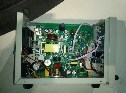

Definitely a rebranded one, I found dozens of different brands for the exact same looking model. It's pretty common to see them rebranded even with the better quality ones.
The specs seem to be 50mV of ripple, given they promise 10A in such a compact looking size I bet it's purely a switchmode supply.
I did find a picture of one in a review: https://ae01.alicdn.com/kf/UTB8j_i6H8ahduJk43Jaq6zM8FXav.jpg
Doesn't look linear to me!
« Last Edit: June 04, 2019, 04:21:16 pm by JackJones »

As mentioned, some power supplies use a switching mode preregulator to increase efficiency then a linear final regulator so there is a low voltage drop across the linear stage for low heat dissipation and you get the added advantage of lower noise and probably better regulation.

Too large capacitance at output terminals.
