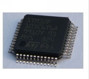

I fried a STM32F103C8 microprocessor once, and bought some replacements. I'm very very new to SMD soldering, and broke some pads and have a few on the verge, getting it and new ones off...on/off/on .
So now I have a chip almost on there with 2 jumpers instead of pads. But then I broke the 2 pins off the chip, it's 2 right next to each other, at least on the edge though. Kept soldering them together. .
So I'm chipping away at the plastic to get enough to solder to, and that's not going well, should have enough but I need a third hand for my 30x mag. loupe.
Just wondering in general how far in the pins go ? I'm sure it's not like a TO-92 with the leads going right to the die. Maybe 1/2mm or 1mm ?

With an QFP48 you might be dissapointed.
However, it will depend on the size of the die and the lead frame used. An STM32F103 might just fill the QFP48, since you can't get it smaller. Only the QFN 36, which is basically the same plastic size, without leads.
(source of image: http://www.prioritylabs.com/engineering-services/x-ray/)
Image is not an STM32F103.
