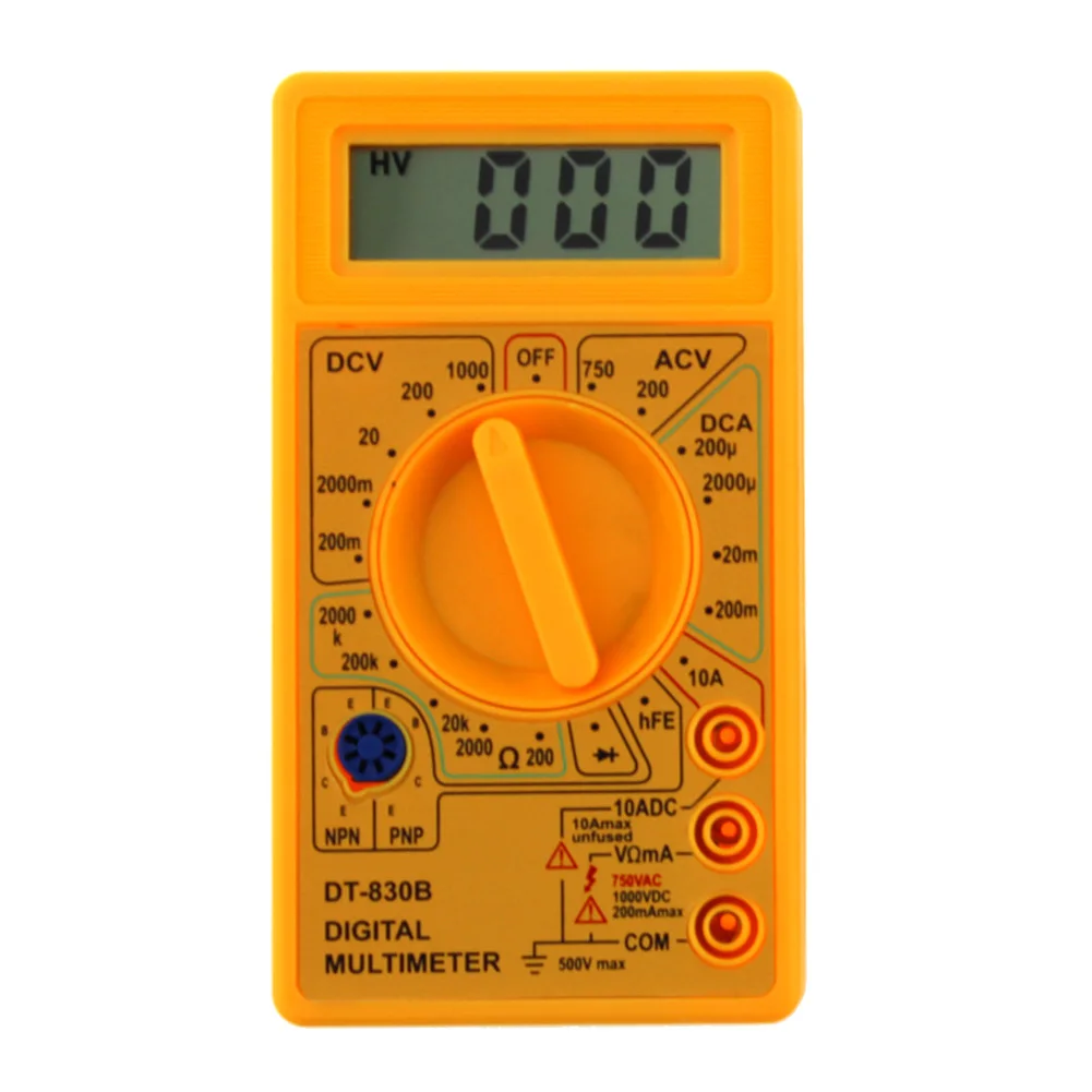

Not sure where you live.  But if you're in the US I suggest you buy a pack of gum at Harbor Freight and get a free DMM.  With a cal they are good to better than 0.1%.   And you can do the cal with some fresh batteries.  All you need is the right coupon.
Life is too short for non-autoranging DMM ^-^. Also non-fused 10A range is something I'd avoid for someone that's just starting. If I got one for free sure I'd toss it in a toolbox as spare, but I woudn't want to pay for one
The test probes are fragile, but a bit of hot melt glue where the wire goes into the probe is supposed to solve that.
I think that's all cheapish meters, good probes cost more than them for the most part
The 10 A range is fused.  These are the modern equivalent of a Fluke 8000A except for not being rated to 1200 V.  Beginners should not be playing with high voltages, so that hardly matters.
Is it ? On picture you attached shunt seems to go directly from COM to 10A., just like on  other types of it. I did saw some other teardown that did seem to have it separate, so it might depend on model.
They look like same kind of meter I've used 20 years ago when I was a kid (well ones like that[/url;] ). Those didn't had 10 A range fused either.
A beginner should be conscious at *all* times of what they expect the meter to read.  A manual ranging meter encourages developing safe work habits.  Autoranging meters tend to encourage just poking the probes in.  That can get very spectacular if it's a CRT or microwave oven  HV section no matter what DMM you're using.
If someone sets manual ranging meter to highest range and poke microwave or CRT, result will be as bad.
I don't really see a value in manual ranging (and you can do that on auto meter anyway if you really need), just adds to annoyance when probing unknown circuit. Fine for a cheapie (for price of HF meter you get amazing deal all things considered) but IMO getting anything above $30 with manual ranging is pointless.
A well equipped electronics test bench is not cheap.  I've got more of the HF units that I can count (or find).  I've had only one fail.  A 34401A certainly meets the OP's requirements, but I think all would agree it's rather overkill for a beginner.
The HF DMMs are one of the few Chinese T&M devices I don't dislike.
By the time you add up a DMM, DSO, AWG and PSU it's not cheap.  You can fix a lot of things with just a DMM, but you *really* need to know what you're doing to be able to do that.
I just thought I should point out that a DMM is like your first shot of heroin.  After that you want more.  The TEA thread is testimony to that problem.  So buying more than you need at any stage is questionable.  And it's pretty hard to beat free.
Agreed. If I had $150 to spend on beginner's T&M I'd definitely not burn it on meter. Just cheap meter + used analog scope (or, in case of digital, cheapo logic analyzer) would be WAY more useful than $150 meter
