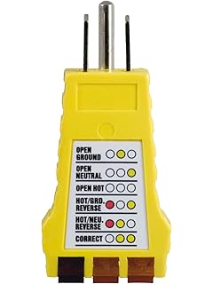

A) Also get one of these and check your wall plugs ... https://images-na.ssl-images-amazon.com/images/I/71AGESwD7kL._AC_UL320_SR240,320_.jpg
B) and last but not least use different wall outlets (in different rooms).
C) unplug your TV and router and computer(s) and try again

I have tested the outlets for wiring issues, and tried moving the scope to use different wall outlets around the house.
The common variable seems to be that in rooms towards the front of the house - in view of a known RF mast some kilometers away - the signal is very strong. In other rooms towards the rear its only just detectable.
