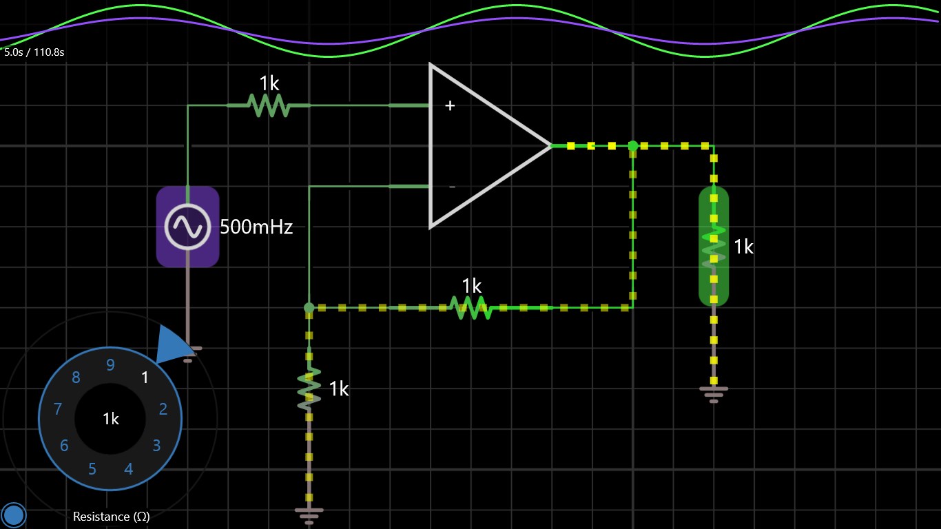

Offline kripton2035
  • Posts: 2713
Re: Free circuit simulator ?
« Reply #24 on: March 31, 2019, 08:31:02 am »
I bought icircuit some times ago for this purpose: quickly check simple circuits, and I LOVE it.
for some $10 it's really worth it.
exists on win,mac,ios and windows phone.
http://icircuitapp.com/
edit: it's even $5 for windows ...
