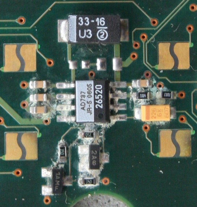

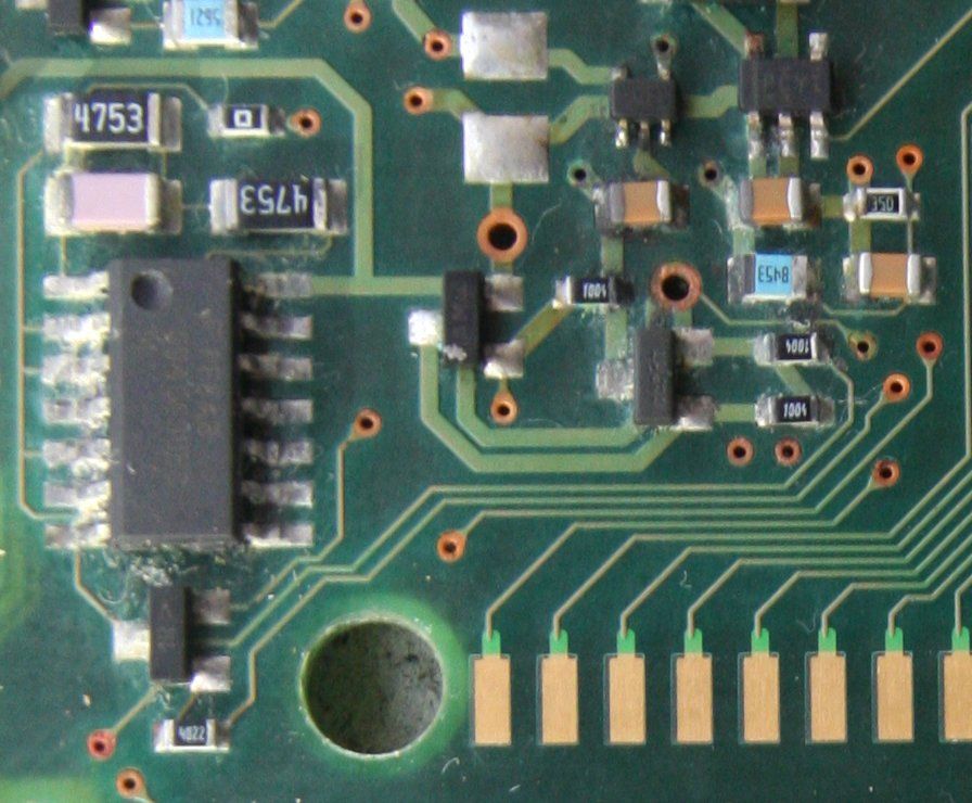

Here are some photos. I didn't really have the right lens for this ...
I cleaned it up best I could using isopropyl alcohol, water and a toothbrush today. A hairdryer was fine for evaporation. It came up ok but not anything like new, of course.
Seems that a battery had definitely leaked in it's compartment. The images here show small isolated parts of the board. Damage was widespread but in localised regions. I can't really see how it could have happened that way. It's not like there are signs of continuous acid flow across the surface. More like it was transfered through the electrical conductors and emerged in different parts of the board. Or maybe it was vapour? Who knows.
Now I'm curious. Can anyone explain the differentiated colours? Why some regions have surface oxidation and in others metal appears to be stained brown?
« Last Edit: October 09, 2012, 11:39:07 am by glee »

« Reply #8 on: October 09, 2012, 12:48:24 pm »
It's not that bad. Apply some flux, hot air and then IPA with a small brush.
My guess is that what did the damage is rain water. Rain water tends to be more acidic than tap water , combine that with the various metals present on the board, copper, tin, possibly lead if not ROHS , the metals mix, electrons move  and it corrodes parts.  The clue for me that it was something acidic is the copper turning green, copper will not do that in a standard 7.0 ph tap water.  If it were salt water you would see way more corrosion.  You can do the same thing with a copper wire and some zinc, place both in a slightly acidic, 6.0 ph,  solution and watch the process turn the copper green and the copper plate itself onto the zinc.

« Reply #10 on: October 10, 2012, 10:58:53 pm »
Ok, that's interesting.
Mysterious that it's so localised in different regions of the board, and remote from both the battery compartment and the input jack sockets.
I wonder if acid rainwater can explain the dark brown staining to the lower left corner of the board in the last image? This discolouration seems to be deep in the fibreglass itself. Certainly seems as if at least that corner has been exposed to some bulk liquid. The case seals seem original and intact, so it's a little hard to understand.
I guess it's feasible that rainwater came in through the connection jacks and mingled with the battery directly below - but then most of that part of the board seems relatively ok, tarnished and dull but not actually corroded or stained.
Anyway, understanding "exactly what happened" is not the goal here. I'm just trying to develop a better sense of interpreting the outcome for future reference.
