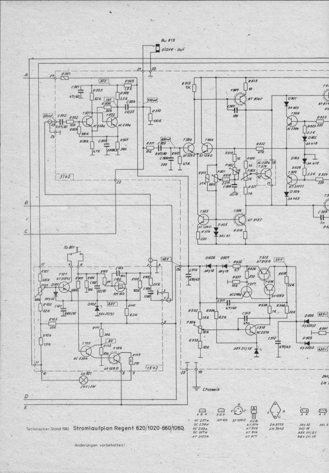

Recently i found another vintage amplifier and started trying to do some repair. This one has -dc supply on the output though. Output transistors are ok. Decided not to open a new topic for a quick question. What is the purpose of T505 and T506. It kinda looks like a current mirror but shouldnt T506’s base be connected to its collector? Where exatcly is the signal path for the “negative” part of the curcuit? Also there should be signal on T503’s collector, right? Schematic is here:
  https://2.bp.blogspot.com/-caBoNeF4L1M/UmSsQvmugGI/AAAAAAAAC6c/u7ErQenGXf8/s1600/660_2_2.gif
https://3.bp.blogspot.com/-aHtKx9ZJ5ss/UmSsQsr6ryI/AAAAAAAAC6Y/nRZxCKyJ8Ps/s1600/660_2_1.gif
Hope i dont get annoying with stupid questions about old amplifiers. :)

No current mirror, but two constant current sources. Base voltages fixed by diodes (1.4 V above negative supply), current determined by emitter resistors. Signal path is from T503 to T507.
