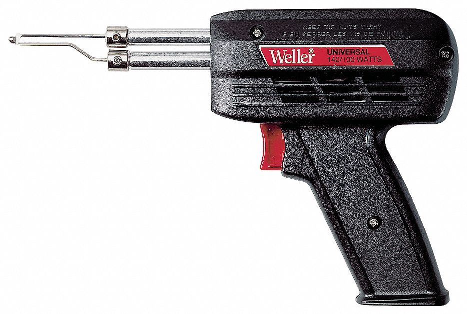

I used to have trouble with some stubborn components and their large pads, until I got one of these for me: a Weller 8200PK.
Obviously you need to be extra careful in not ripping everything else from the board with overheat, but it works like a charm.
