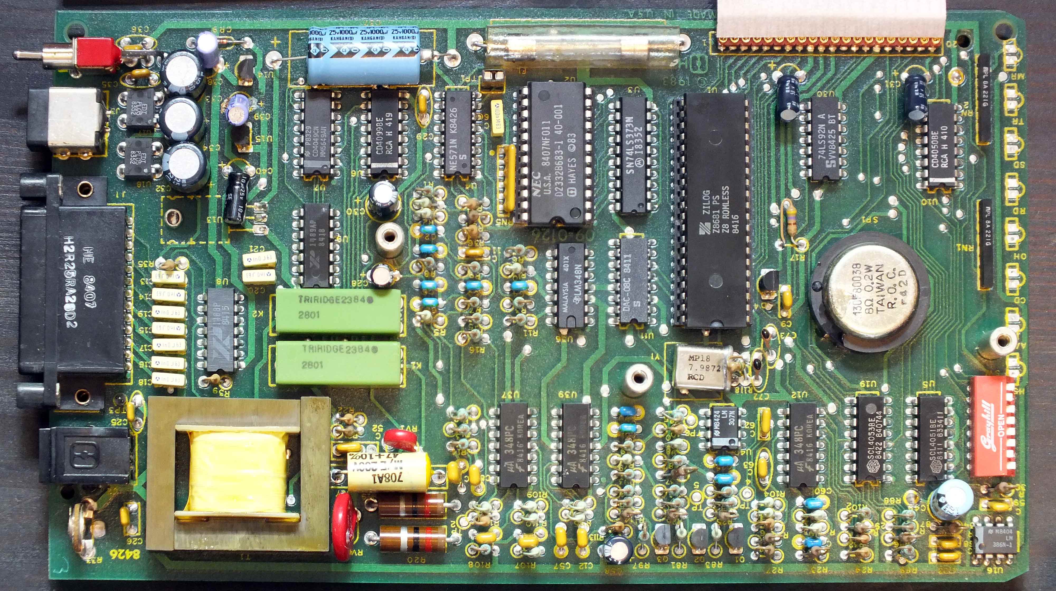

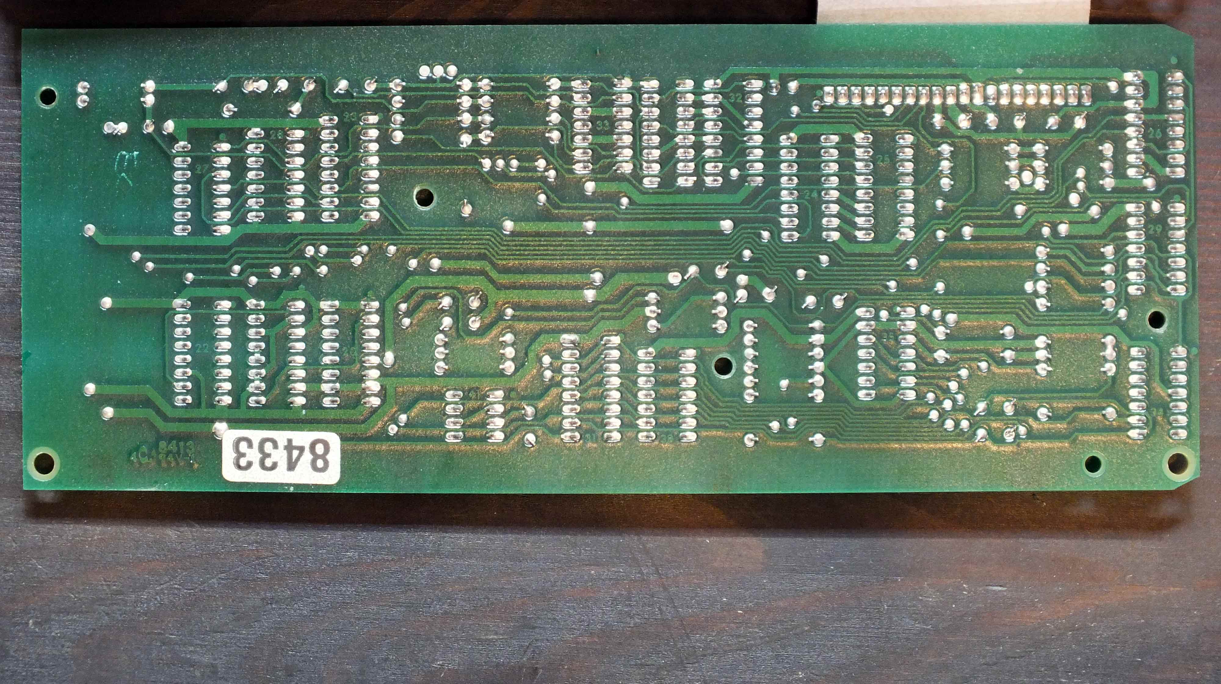

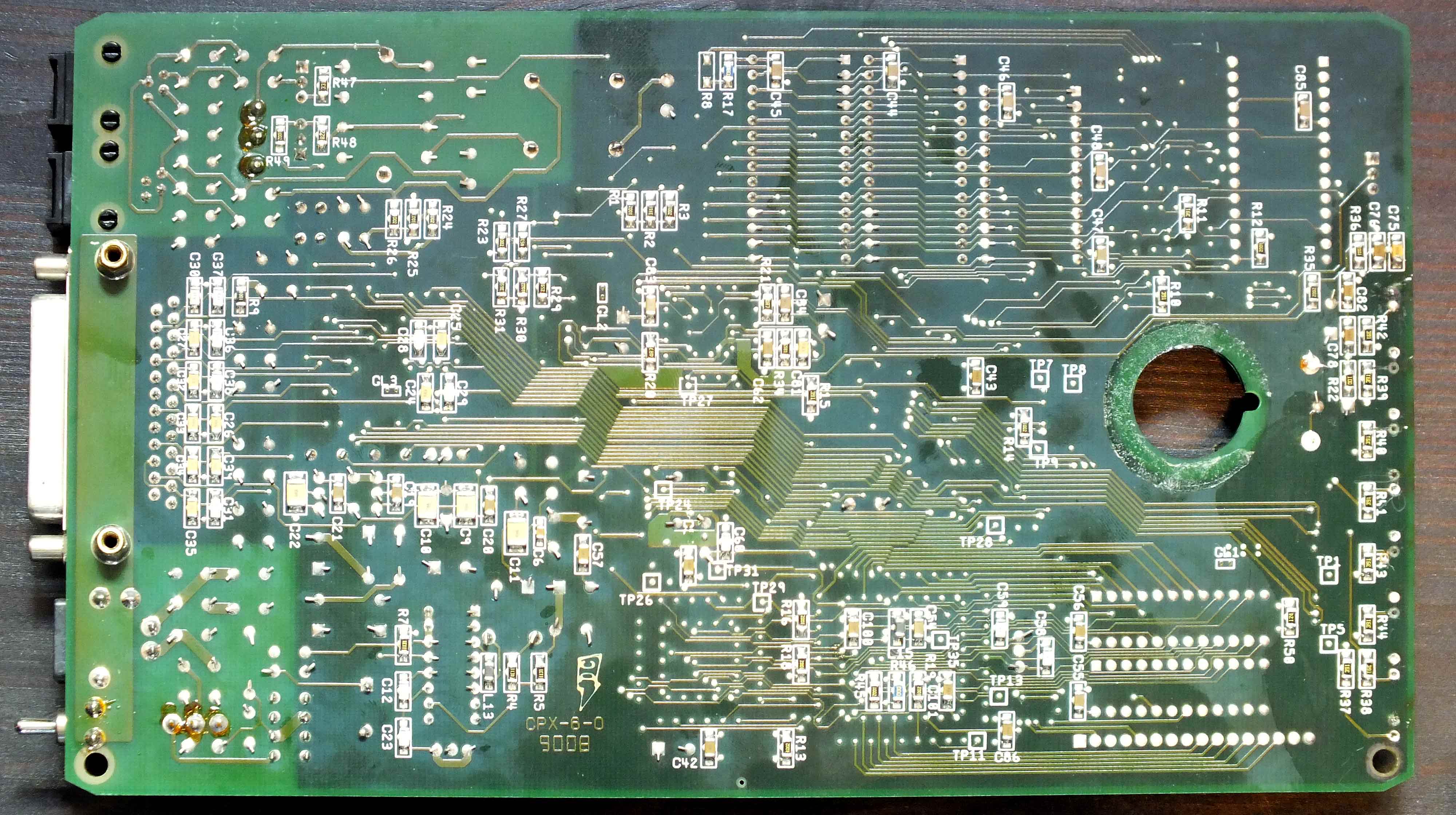

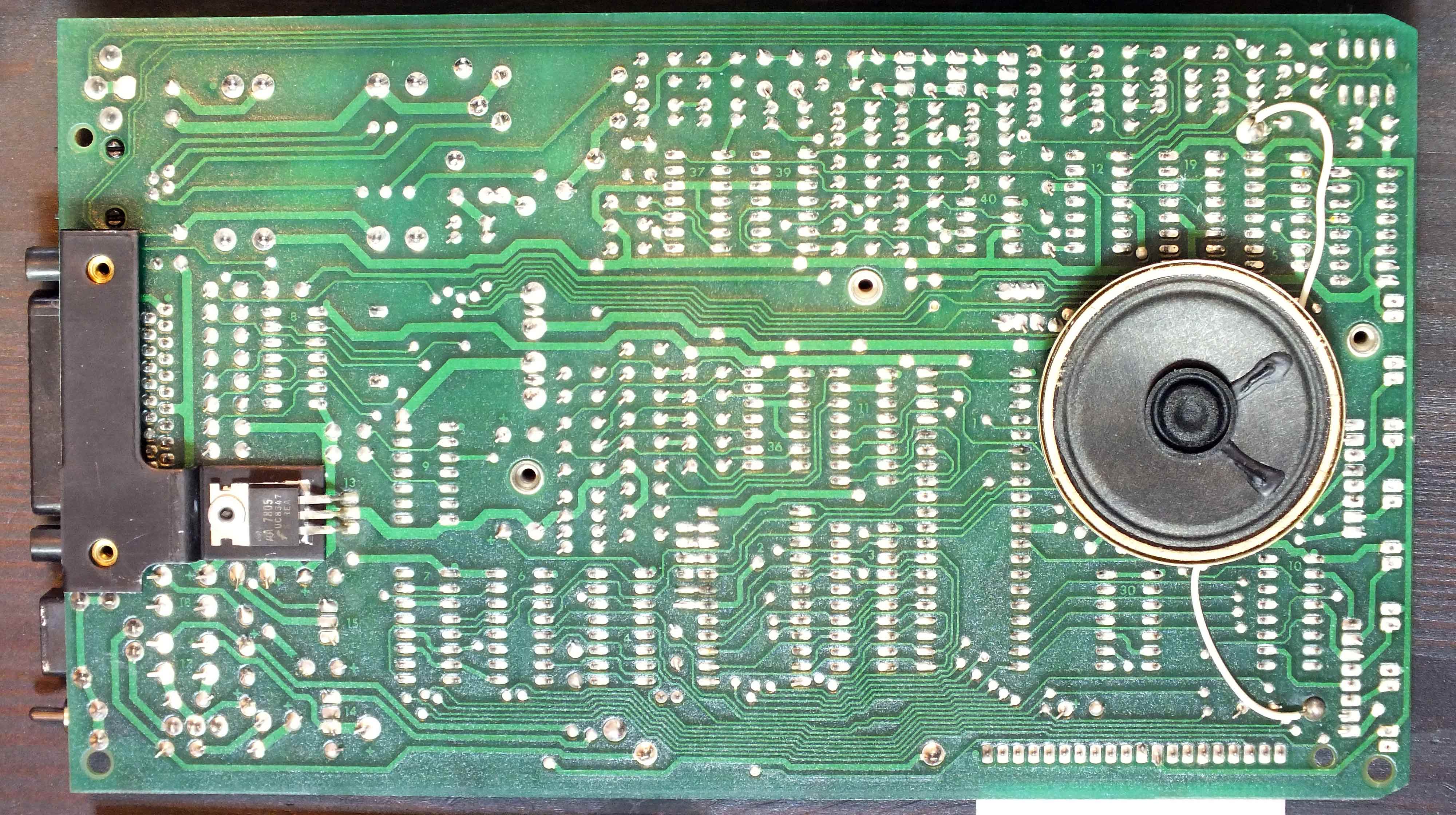

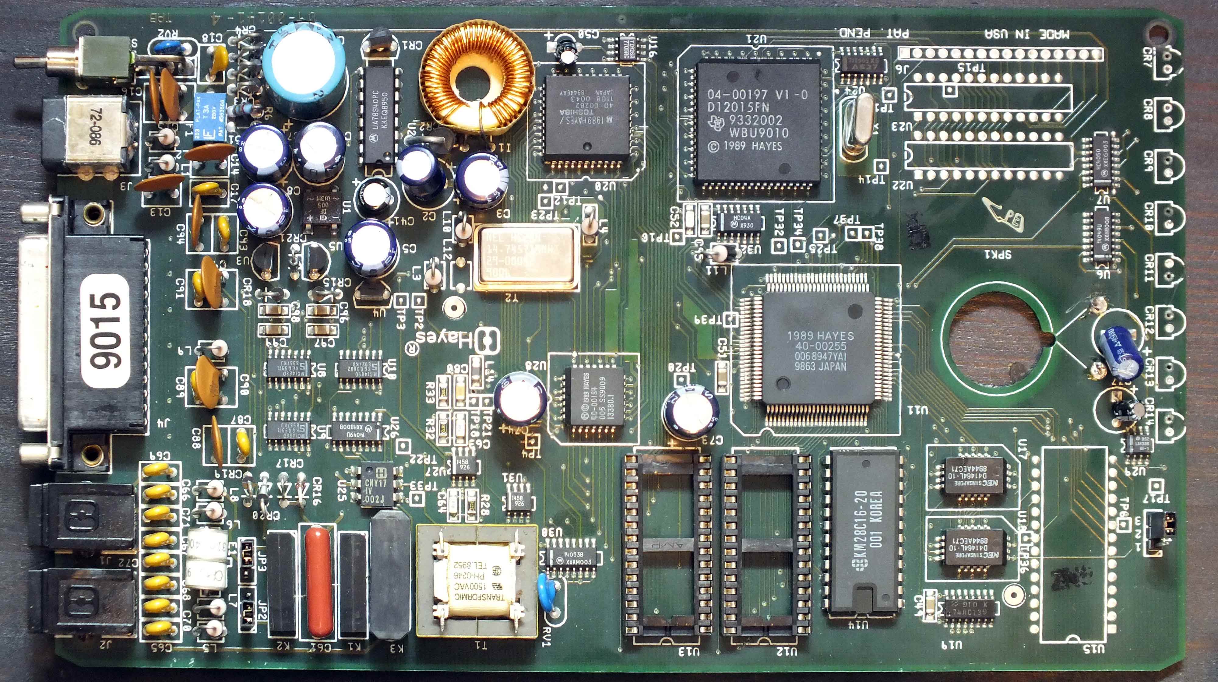

I couldn't find any schematics for Hayes modems, but if you could take a hires pic of the top and bottom of the PCB, we might be able to figure out what voltages the original LEDs would have been driven at. Possibly 9V for the 400Ohm resistor ones.

And here are the high-res photos of the modem circuit boards that were requested. Because they're so big I'll just provide links instead of inline images. The LEDs were soldered on over on the right-hand side:
1200 bps modem - component side:
http://www.nullmodem.org/eevblog-photos/1200-front.jpg
1200 bps modem - back side:
http://www.nullmodem.org/eevblog-photos/1200-back.jpg

1200 bps modem - daughter board back side:
http://www.nullmodem.org/eevblog-photos/1200-daughter-back.jpg
9600 bps modem - component side:
http://www.nullmodem.org/eevblog-photos/9600-front.jpg
9600 bps modem - back side:
http://www.nullmodem.org/eevblog-photos/9600-back.jpg

« Reply #22 on: February 01, 2020, 09:19:27 am »
Those look like 220 ohm resistor SIPs on the 1200bps pcb...
Offline mariush
  • Posts: 5171
Re: How can I determine the resistor value for an unknown type of LED?
« Reply #23 on: February 01, 2020, 09:40:47 am »
Yeah, I agree... 221 is code for 220 ohm 22 x 10^1
You can see in the back that each led goes through two pins on that resistor network.
As for the 9600 bps modem, I see 390 ohm resistors on the back of the circuit board (it says 391 on the resistors).
You could use a multimeter to measure the voltage before the resistor on both modems and from there you can measure voltage and current
You can also use Vin - Vforward = Current x R  and you know the resistor and you can measure the current across the led with the multimeter if you want to.
