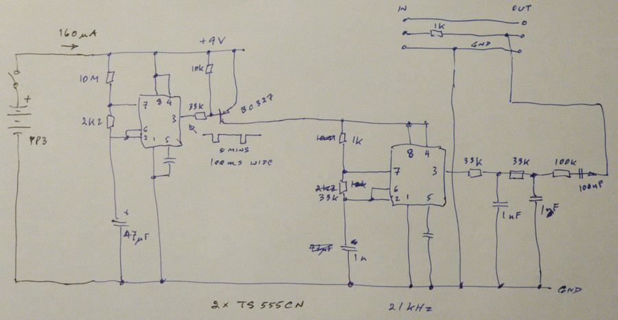

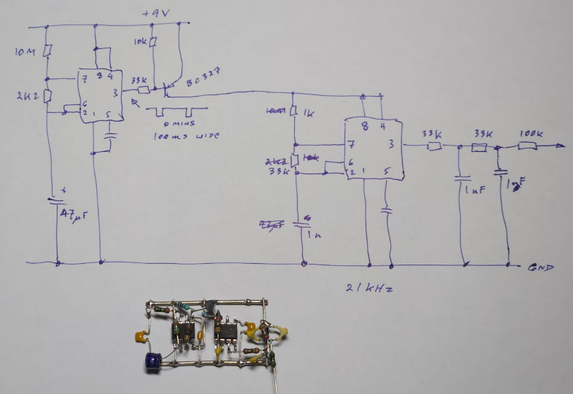

This circuit will inject 20kHz for 100ms every 5 mins into one of the two audio channels going to the soundbar
I am not yet sure of the required level i.e. the value of the 100k resistor on the output.
The two chips are CMOS 555s.

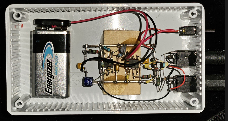

BTW I think the above circuit could go inside the soundbar. The PSU there must be powered all the time, otherwise the remote would not work. Such a stupid regulation - so typical of Brussels ;)
Otherwise, it should draw about 200uA so a PP3 should last almost a year.

Done it:
This should work with any soundbar.
In fact it should be possible to power it from the soundbar's internal power supply. This is always on, otherwise HDMI and other auto turn on features would not work. The auto shutdown is just a fake to comply with stupid Brussels regs :)
One could also replace the 1st 555 (which draws the 160uA) with a smarter low power timer, and extend the battery life to 5-10 years (they corrode anyway in that time).
« Last Edit: December 01, 2024, 07:18:06 pm by peter-h »

Sometimes an analog solution is not the best option.  There's a lot of parts there to do a very simple job.  If you've got *any* MCU programming experience, scrap everything to the left of the output filter and replace it with an ATtiny or similar low power low pin count eight bit MCU, programmed to sleep for approx. five minutes using its watchdog timer, then generate the tone burst and go back to sleep.  It will also need a micropower LDO regulator to keep MCU Vcc stable as the battery ages, unless you can put it inside the soundbar and find a 5V standby rail to power it.
See my sig for CPU types :)
Actually it would take much longer to do this in code. It took me about an hour to build this circuit.
The ATTiny2313 (the replacement for the 90S1200 which I run in a number of products) would draw 20uA in sleep mode which is pretty good though. But it would be at least a day to get it done. If I was to sell this commercially (which may be viable due to the number of these stupic soundbars with auto shutoff - basically all of them except some are OK if used with an HDMI ARC TV) then yes I would probably do that, but it still needs to be programmed in production whereas the timer approach you just build...
Online Ian.M
  • Posts: 13200
Re: how can I disable auto-standby on TV soundbar?
« Reply #25 on: December 01, 2024, 09:15:41 pm »
You are obviously an expert dead-bug/freeform prototyper, and I have no doubt that for *YOU* it was faster to prototype just with a soldering iron rather than switching to coding half way through.  However many here are less good with an iron and would benefit from considering the MCU approach.
Online peter-h
  • Posts: 4286
« Reply #26 on: December 02, 2024, 07:44:42 am »
It's call a "birdsnest" over here :)
If you use a micro then you have to birdsnest that too, or use some sort of evaluation board, or design a PCB. And you still need to solder. It's going to take way longer.
This is only a 100 quid soundbar...
Why use two 555s? A single 556 will do.
And why PWM the power to the second 555 when you can just PWM the reset pin?
This circuit works at 40kHz, at a repetition rate of 100Hz, but you get the idea.
* 555 burst.asc
Online peter-h
  • Posts: 4286
« Reply #28 on: December 02, 2024, 09:59:10 am »
The idea is to not have any power on the 2nd 555, 99.999% of the time.
Can't do that with a dual 555.
Offline Zero999
  • Posts: 20212
  • 0999
« Reply #29 on: December 02, 2024, 05:50:53 pm »
If it's about low power consumption, then two oscillators made with the '4011 or 4001 quad NAND or NOR gate IC will use less power than two CMOS 555s.
Online peter-h
  • Posts: 4286
« Reply #30 on: December 02, 2024, 07:52:50 pm »
That's true. And one could get into the nanoamp area with a circuit built with some discrete MOSFETs...
But even better to put this inside the soundbar.
