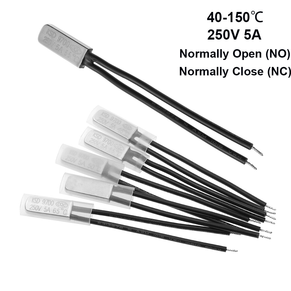

I have used a few of these on Test gear fans to keep them off until really needed, generally I use 50C bolted to the heatsinks near the power bit and they are close in Temp and work well. Only for a source photo not a source  ;) eBay auction: #273816889118 If you need more power than they will run then use a relay. Dead easy and minimal bits to go wrong. Call this the KISS option.
The other obvious question I assume you are not using Temperature rise above ambient to turn on the pump for a physical reason otherwise I would be doing this and take the operator out of the loop even add a second higher temp for a safety cutout.?
