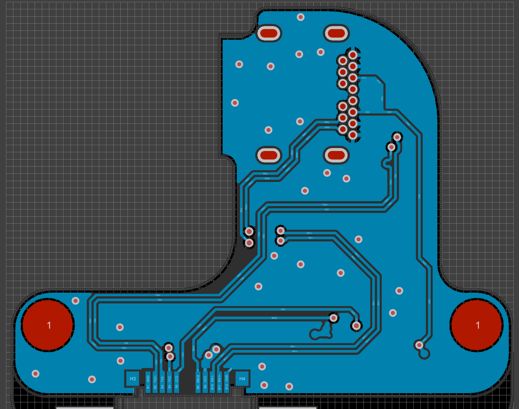

Hi all
I have a circuit board that I freelanced out the design of.
Had it made and got a pro to solder the USB type C plug and socket on for me (0.5mm pitch I wont touch xD)
The board extends the USB Type C socket about an inch from the plug.
I can get it to work in USB 2 mode but not USB 3.
Sometimes I can get the board I soldered to work in USB 3 but this is very rare.
What are my options here to debug this and find out what is going wrong?
Thank you
Jack

Seems you have signal integrity problems. If you can - show schematics (at least part in question) and photos of PCB, both sides. Provide links to info/docs of chip used. If you copied (part) of some existing board like devboard of USB chip - mention it as well.

USB Socket top of board Würth Elektronik 632723300021
USB Plug bottom of board Würth Elektronik 632712000021
Board is 4 layer, the middle 2 are ground only.
Also to note, if I flip the cable from the socket to my PC, nothing works at all. No USB 2.

« Reply #4 on: December 02, 2018, 12:44:26 am »
There might be other errors but on first glance I found this. Those are simply not connected.

« Reply #5 on: December 02, 2018, 12:53:46 am »
Although it explains only why it does not work in one position at all. Not problem with USB 3.

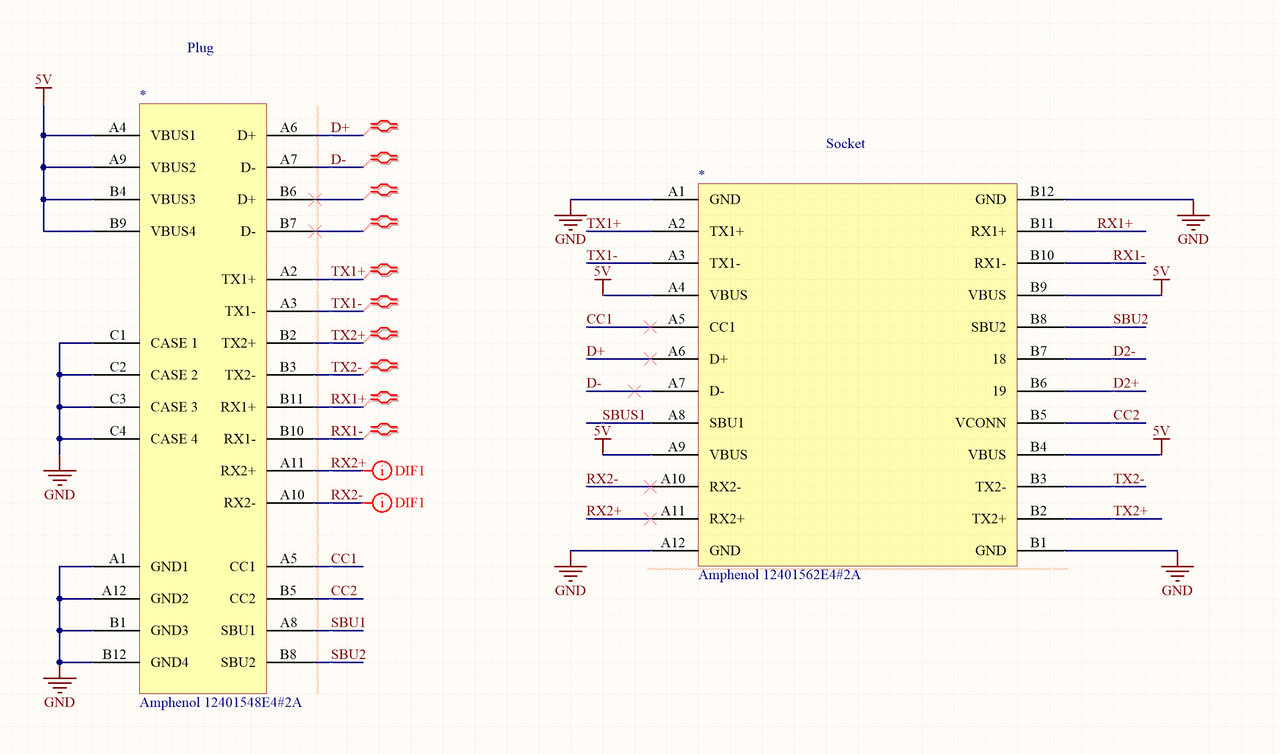

« Reply #6 on: December 02, 2018, 12:56:54 am »
Here is pinout for reference.

« Reply #7 on: December 02, 2018, 01:06:54 am »
Also no GND connection here.

« Reply #8 on: December 02, 2018, 01:12:09 am »
Also strange that CCx and SBUx are length matched as well when it's not needed at all. The best would be to just route them as short as possible.

« Reply #9 on: December 02, 2018, 01:24:31 am »
These 2 holes should not be there because connector does not have such pins and they only interfere with differential pair routing. EDIT: different connector used on PCB

« Reply #10 on: December 02, 2018, 01:28:47 am »
Why different part name in schematic and BOM. Those two are different connectors

« Reply #11 on: December 02, 2018, 01:28:53 am »
Hmm, probably connector is not properly soldered because I don't see 2 holes for plastic guides. EDIT: different connector used on PCB

« Reply #12 on: December 02, 2018, 01:34:24 am »
Now I see why there are no holes for plastic guides and 2 additional holes present. Connector is different. That was misleading.

« Reply #13 on: December 02, 2018, 01:42:59 am »
I believe the schematic parts are just mislabelled.

« Reply #15 on: December 02, 2018, 01:50:17 am »
How could I miss this  :palm:. H1-H4 pads of edge connector are not grounded. Not only it's mechanically weak (I would even avoid using thermal relief on those), basically cable shield is left not connected  :horse:. Now it's obvious why it fails to work as USB 3.
Yeah, 3 different errors on such simple board  :palm:.

« Reply #16 on: December 02, 2018, 01:58:05 am »
I forgot to mention that we noticed that and put a mod wire in to fix the prototype.

« Reply #18 on: December 02, 2018, 11:46:17 am »
Full featured type C cable seem to have 5 diff pairs. Only one diff pair for USB 2.
So as I understand schematic should be like this:
« Last Edit: December 02, 2018, 11:57:14 am by wraper »

« Reply #19 on: December 02, 2018, 12:04:25 pm »
Oh, and Vbus trace is way too thin for supplying any serious current as it should according to USB spec. It should be much thicker and have separate traces running from all 4 pins joining into one thick trace. Not running through other 2 Vbus pins of female connector. Via stitching of GND is inferior for such high speed application as well.

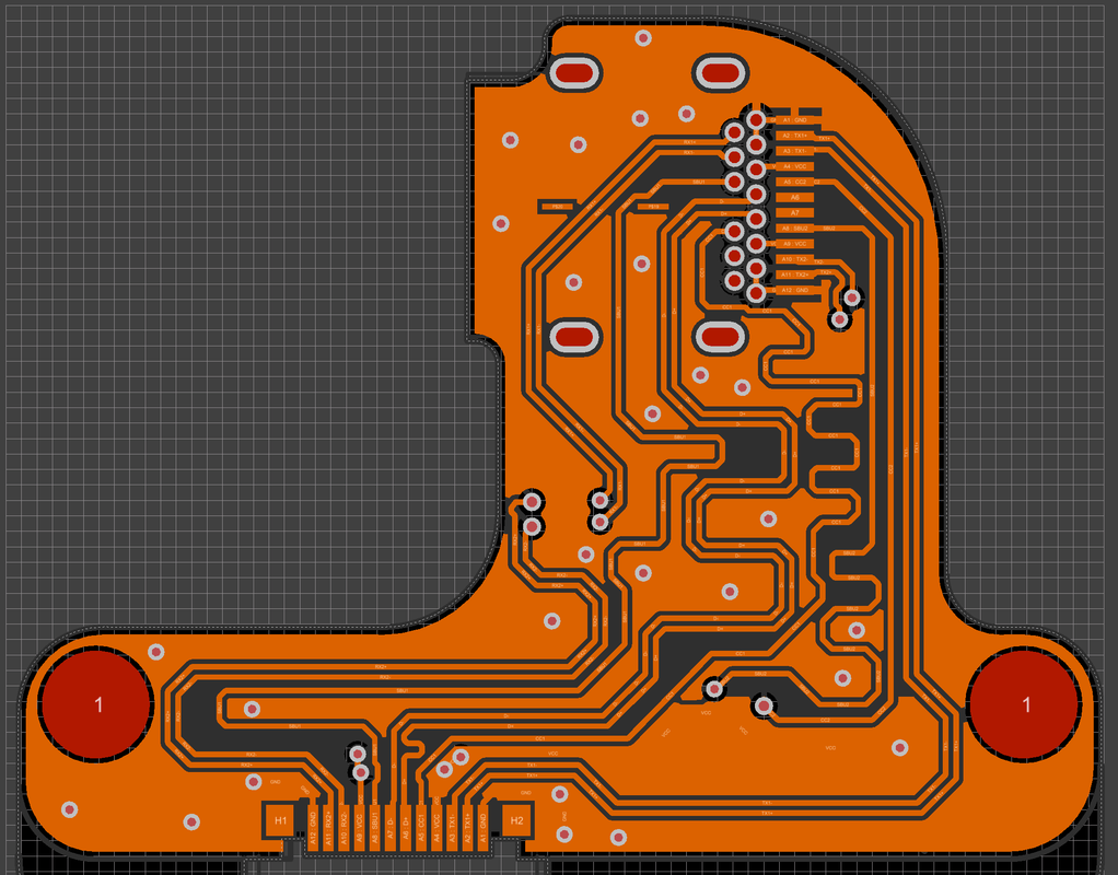

« Reply #20 on: December 02, 2018, 12:13:08 pm »
And it would be better to not have GND fills at all at outer layers rather than having them located inconsistently around diff pairs, thus inconsistently affecting impedance.

« Reply #21 on: December 02, 2018, 01:20:39 pm »
That board does have a buried ground plane right? If not I think you have diff pairs crossing reference planes in a few places, never a good look at these speeds.
