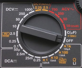

Re: Panel meters.
« Reply #7 on: October 06, 2021, 06:21:00 am »
...The meter feels quite heavy compared to the same physical size volt meter, I've no idea if it has a built in shunt. The only thing I can think of doing is measure the Amp meters internal resistance, would that tell me if this meter had a built in shunt ?
The heavier meter may indicate the existence of a shunt. The terminal bolt size may also be a pointer. A very low resistance across its terminals would confirm it.
It could be measured, using an analogue multimeter, selecting the highest 'kΩ' range that would pass only a few μA of test current.
The range may then be lowered in steps to confirm the existence of a shunt.
