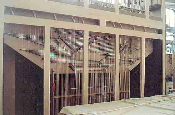

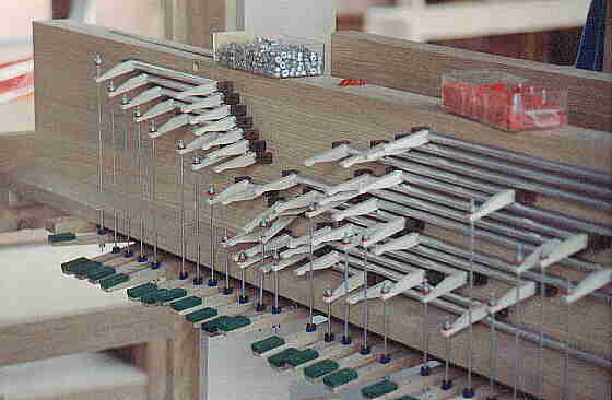

Are you sure you want to remove the tactile "feel"?  One of the great disadvantages of electro-pneumatic pipe organs is that they remove all the "feel" from the keyboard.  And it ends up feeling like pushing an electric doorbell button.
That is why people still make "tracker" organs with hard mechanical linkage between the key and the "pallate" valve. Here are photos I took at the Rieger Orgelbau factory in Bregenz, Austria...
