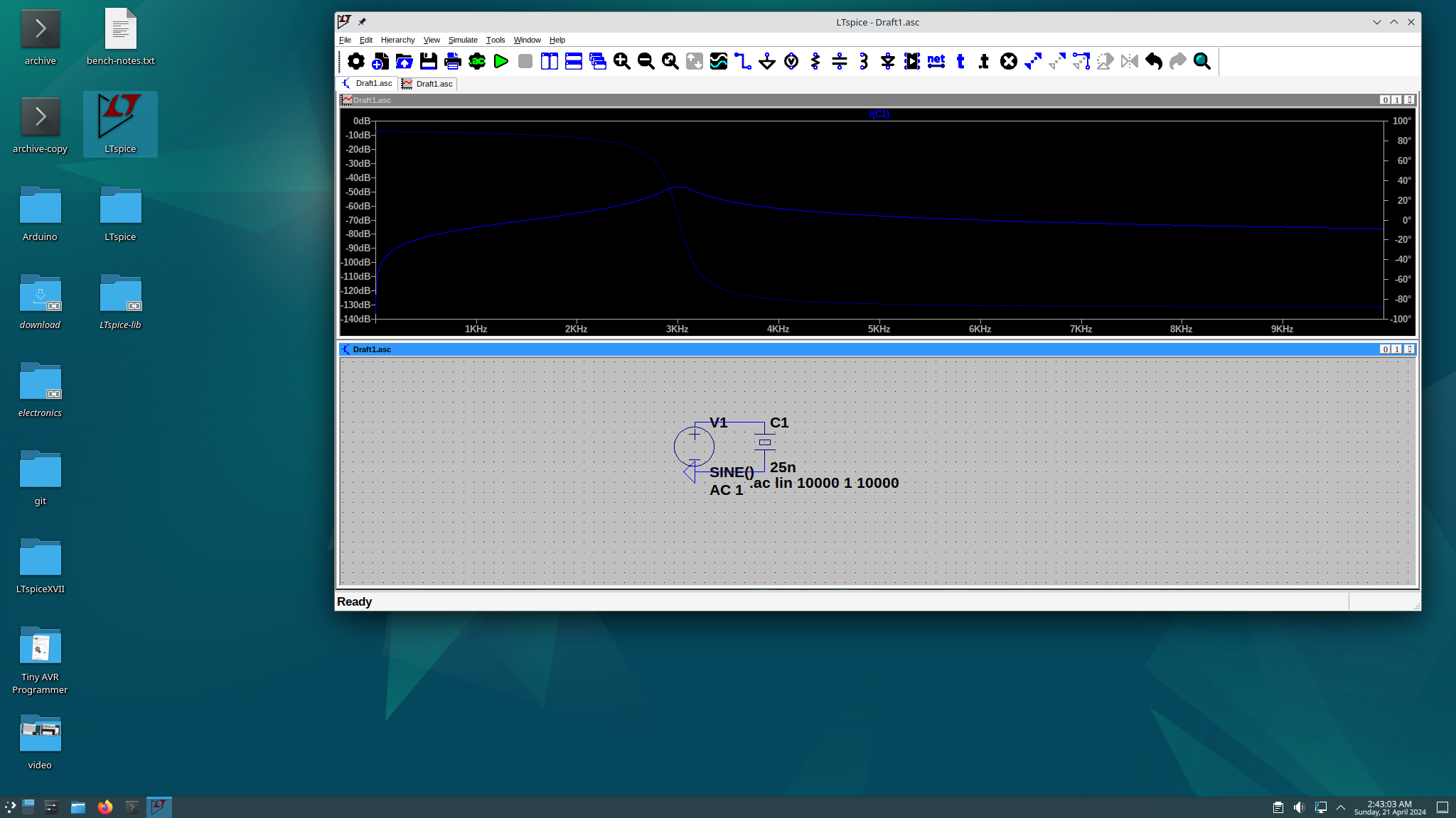

I had a go at doing a sweep, does this look right?

Your plot looks pretty correct to me.  The db scale on the left is a bit arbitrary, you can make the peak 0 db by adjusting the amplitude of the source and then get more meaningful data related to the peak.  These sweeps are also usually db on Y axis (a logarithmic unit) and log in frequency along X axis. If you're log log, you can easily pick out rolloff like 20 db/decade etc.   These types of sweeps are called BODE plots- something for you to follow down the rabbit hole on...  They're a very powerful tool and in a little more advanced form which includes a phase plot can give you an indication of stability, etc.
As the last poster said- some of this analysis of acoustic devices in just spice don't give you the whole picture.  When you mount a transducer and put it into an enclosure, all this nice RLC type analogy gets modified by what ever "resistance" the mounting does and the resonances in the cabinet- much like speaker design.  Often piezo discs are mounted lightly with superglue at there edges and put in a cavity that acoustically enforces the sound.  More to play with...
