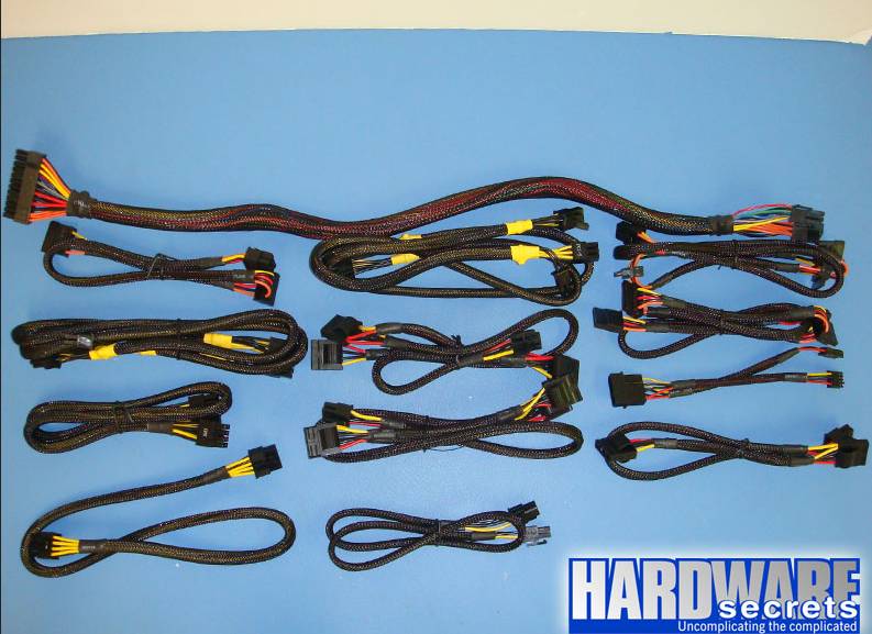

The Seasonic X-650 I have has some sleeving but you can still see the yellow and red cables, they look like this :
I want to extract each barrel or wire from connector and put sleeve on the cable at least until it goes under the large sleeving that covers the whole cable. So about 10-20cm of sleeving on each wire on the cable. If the colors are still too visible under the large sleeving, I may do the whole length - I can only buy sleeving in 25 meter lengths so I'll buy a lot of sleeving anyway.
The alternative would be to buy about 100 meters of AWG18 wire and replace the original wires with my own.. but wire is actually more expensive than sleeving in small quantities, and I'd also have to buy the actual barrels/connectors and I only found them so far (i admit, i didn't look much) in packs of 60 for about 20$ a pack. So overall, it would be more expensive than just sleeving each cable.
The KM3 revision of the same power supply comes with these cables which look way better:
