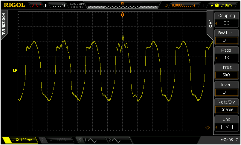

There are occasional odd shapes to the output signal:
generally the output signal is noisy:

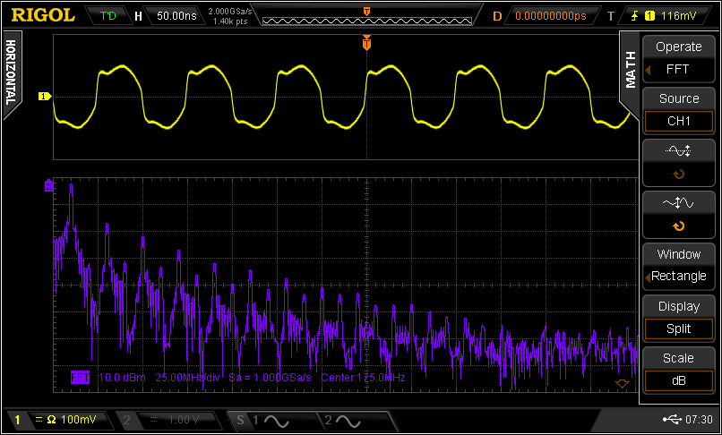

and an FFT of the spectrum shows loads of harmonic content:

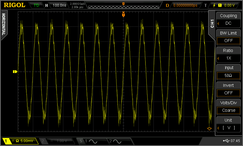

If I probe the output of the OCXO directly its noisy too:

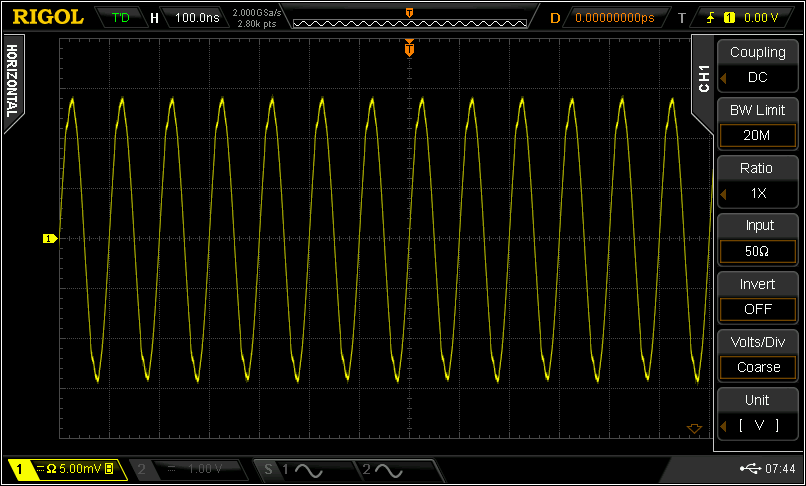

and with 20MHz bandwith limit:

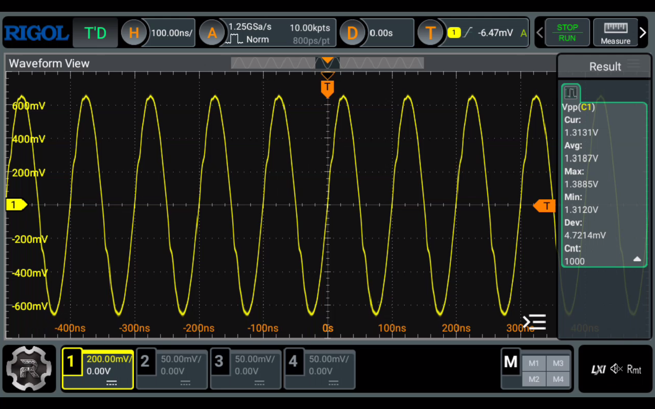

I assume the scope is set to 5mV per division here. That means the signal out of the OCXO is only 30mV pk-pk. This seems much too low, since the DS90C402 has a ±100 mV threshold sensitivity.
Do you have R13 installed? Maybe you should try removing it.
Also: Does the  "\$\Omega\$ 5mV" on the scope screen mean the input is set to 50 ohms? It shouldn't be for that in-circuit measurement.

Let me try that again, with my new shiny 'scope, this is the OCXO output connection to the board:

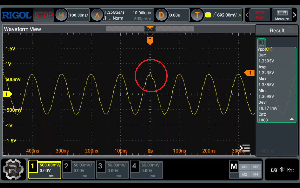

This is the occasional noise that I'm concerned about:

« Reply #15 on: July 13, 2024, 04:03:49 pm »
The video is quite illuminating.
Are the noise bursts in sync with the one second pulses from the GPS module? The noise bursts seem to peak at one second intervals. Probably from the microprocessor waking up and running code with each pulse from the GPS.
You need to figure out whether it is conducted noise (via pwr or gnd loops) or radiated noise. I'd try having everything connected together and running, but powering the OCXO from a battery supply to see if the noise goes away. If I still saw the noise, then I'd also disconnect and feed the OCXO's Vtune line with a temporary resistive divider and bypass cap. All with short leads and from the battery. If I still saw noise, I'd suspect radiated noise and start looking at shielding/layout issues.

« Reply #16 on: July 14, 2024, 03:45:18 am »
I think that is exactly whats happening.
I will do as you suggest and report back.
