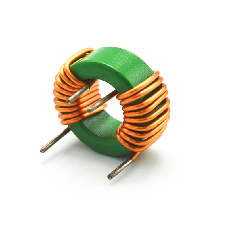

I'm wondering if it's possible to make basically a microscopic iron-core toroidal transformer like so that can retain it's magnetized state without power:
I can't afford to buy a gazillion iron cores, but I do have a ton of (probably 300 or so) unused trash-picked floppy disks stuffed under my bed and am wondering if the film for those would work for what I need.
or would the film be too restrictive to carry a proper magnetic current??
thanks :)

I mean, that's what disks are, they're core memory where the core spins past the winding(s).  Can't you just use it as-is? :P
Good luck making discrete cores out of film, the layer is quite thin so mu_r and Ae will be very low.

you're wrapping 2 coils around a small toroid of film (shown in the OP)
there's no motor involved...
I just need to know if the film will carry the field from the primary coil to the secondary coil.
EDIT:
to give you an idea of what I'm trying to achieve
the thickness of the toroid in the image would be the thickness of the floppy film
« Last Edit: December 30, 2019, 05:20:19 am by Tcll »

I know what you're talking about, using the film as a core, and I already noted
You're welcome to try it but I think you will find the geometry in the OP will be ineffective.  Low mu_r gives low coupling, and low Ae gives low core flux.  You may see some effect on self-inductance but it won't be nearly as clean of a "pop" as coercive force is exceeded, because of the nonuniformity of field around the film.  Also, expect to need many turns (or a ton of amperes), not a single turn like classic core memory.  Again, because of mu.

yeah I definitely needed that
in simple terms for future DIYers like me who don't understand technology but know enough to make simple circuit boards,
no it would not work as expected, and would not transfer the magnetic field through the film (coupling and flux)
so yeah, I'm better off with sandwiching the film between 2 flat-coil matrix arrays
thank you for your time and helping me understand :)

I mean, that makes things worse, the magnetic path length is even longer; and, I don't get the transmit-receive concept, when everything is reciprocal so it doesn't much matter which side you do it on.
Like, core memory uses multiple lines because of addressing, of course, and it's easier to just add one more (sense) line rather than trying to obtain the read from literally every possible row/column.
In some situations, independent windings can be useful to remove self-inductance from the reading (B-H curve plotting for example), but that shouldn't be necessary here at least for a PoC.
But yeah, as a beginner, you'll be quite confused by all this magnetic terminology.  This is something of an introduction/explanation:
