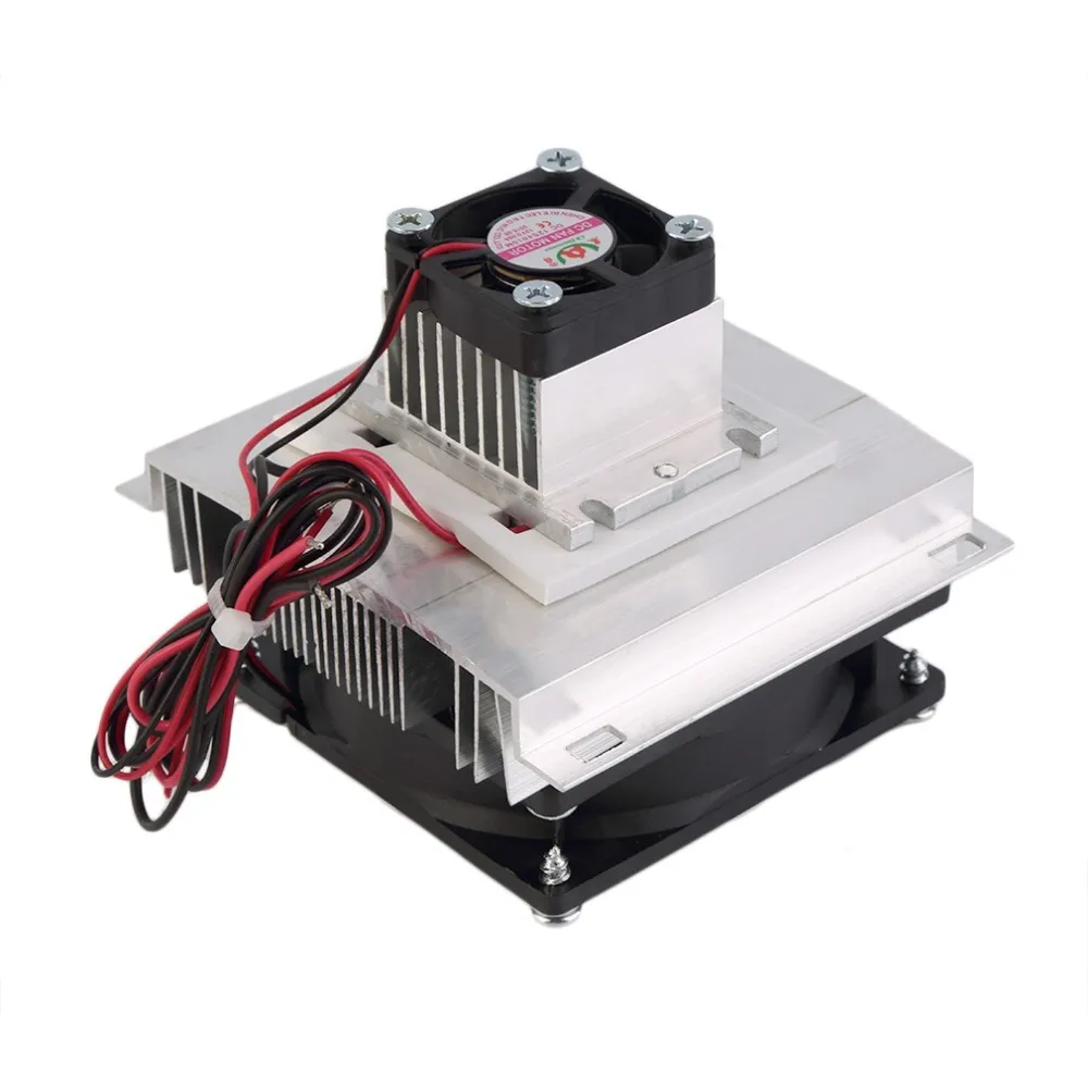

Ok thanks. Peltier should make contact to rtl sdr dongle and it would need a heatsink and a fan in the opposite side. Both (Heatsink and fan) should be outside of the box to dissipate heat.
PD: I was thinking about something like this to build a cooler/heater
