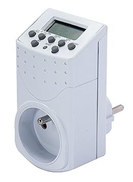

Offline JeanF
  • Posts: 143
Re: Ideas for Automatic garden watering system project?
« Reply #11 on: August 07, 2019, 10:30:29 pm »
Hello,
a few weeks ago I wanted to build a very simple system to water my plants while I'm away. It's very basic but it's a good opportunity to share ideas in this thread. I've let it run for some time before my holidays to have enough time to check it was working well and to spot any leaks.
The main requirements were
- off-grid water supply. (in other words, some sort of bucket). I’m renting the apartment and I wasn’t too enthusiastic about letting homemade pipework under pressure while I’m away
- it shall be very simple and quick to build as I had other stuff to do before leaving
My dad also has two bay trees that would need watering, so for these I used a large 80 liter plastic trash can, a small aquarium pump (Newa MaxiJet MJ750) and a few meters of clear PVC tubing. These pumps can move a fair bit of water at no load, but they have a very small maximum pressure (1.65 meters of water, so around 0.16 bar)
At this pressure, I wasn’t sure the drip emitters that could be found locally would work, and there was not much time left for testing with other emitters (and I wasn’t sure they would be delivered in time before I left) so I thought the small diameter tubing itself would regulate the flow, so I left the end of the lines open.
The timer is a simple mains powered digital timer that I bought for around 7 euros, I’m sure there are many local equivalents. I can program 20 events, each with {day, start time, stop time}, and “day” can be any single day, or each day, or M W F, or T T S, or MTWTF, or SS
https://images-na.ssl-images-amazon.com/images/I/81A4HYyybjL._SY355_.jpg
It’s quite capable for the price, saves the hassle of DIYing one as Ogden said. Only downside is, its resolution is 1 minute, so one can’t water the plant for say 30s, could be an issue for very small pots if the pump is too strong.
