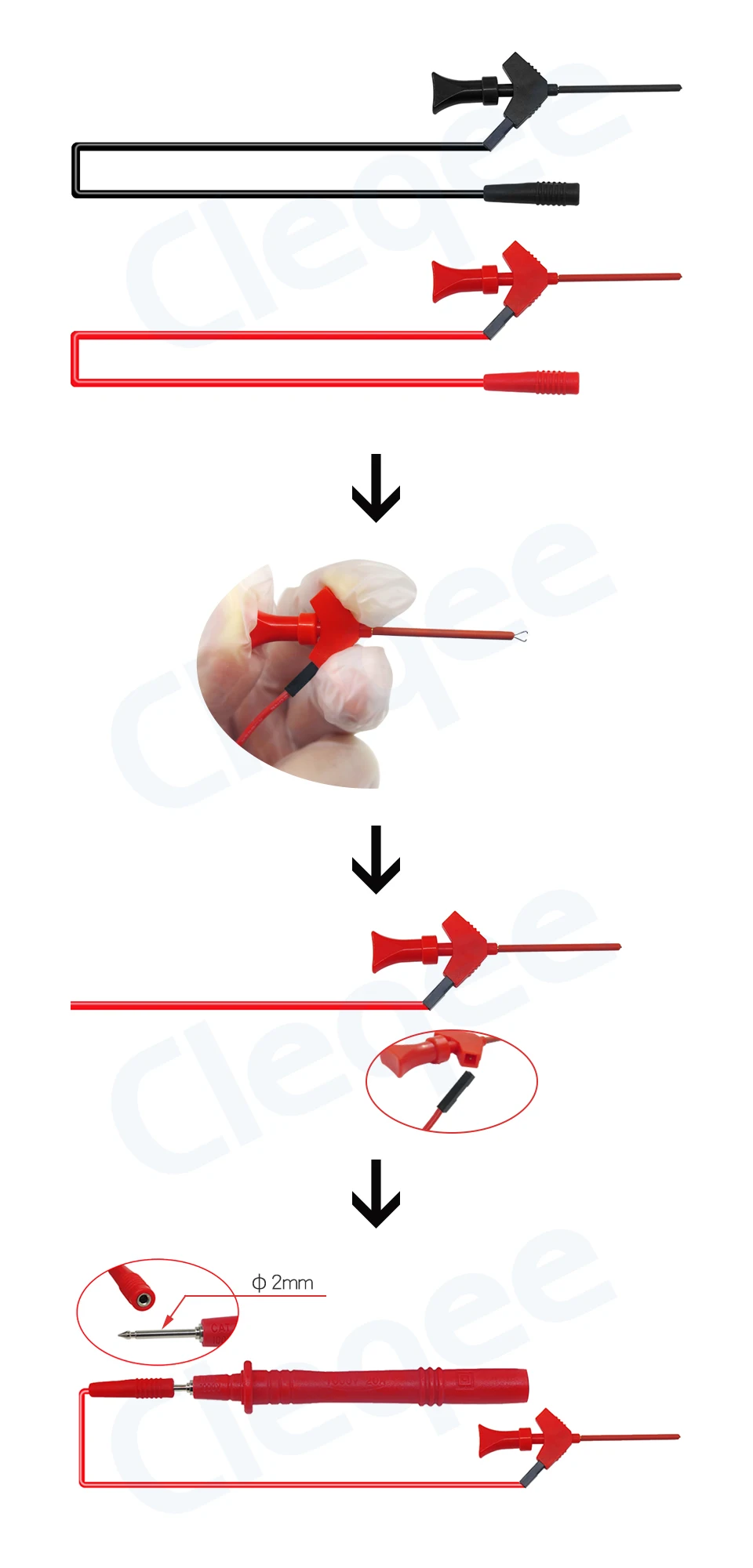

Offline kripton2035
  • Posts: 2679
Re: Generic probe "hook clip" adapters.
« Reply #6 on: April 07, 2023, 03:52:45 pm »
Offline paulcaTopic starter
  • Posts: 4247
« Reply #7 on: April 07, 2023, 04:04:11 pm »
Those look like they will do nicely.
That said, these are 2 sets for the same price.  Taking on board the points about probe weight.
https://www.aliexpress.com/item/32908600661.html

Ample experience on the forums says that cheap hooks and cheap banana plugs end up sucking big time. Don’t waste your money on junk, buy proper ones and they’ll last you forever.

« Reply #9 on: April 07, 2023, 04:23:35 pm »
these are not the same, you don't plug them at the end of your existing probes.
but yes it does the same job in the end...
the probes I linked are smaller too.
