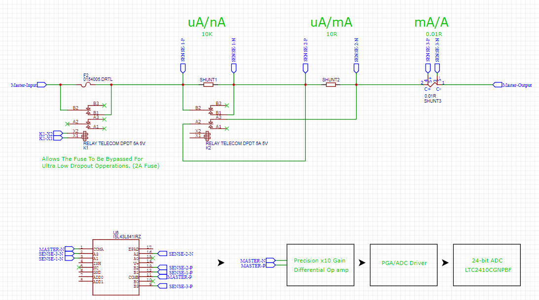

I'm trying to design a precision current monitoring device, and i already have one designed and mostly working based on a 0.01R shunt, an op amp and a PGA going into a 24 bit adc (did'nt even get close 24 effective bits first time). i'm ready to order the components for a version 2, to hopefully fix a lot of the issues with the first version. however with this version i want to implement more current ranges, specifically uA and nA, so i figure i would need 3 shunts. maybe two if i gave up on the nA range.
so basically I want to go from "shunt > opamp > PGA > ADC" to "shunt1,2,3 > switch > opamp > PGA > ADC"
what would be the best way to accomplish the differential "switch" function? reed relays would be too slow and are rather expensive, so would a multiplexer be ok passing signals of such small voltages through it? is there a better solution i'm overlooking? i've never worked with multiplexers and analog signals before, only used them for digital.
i figure that i would need a low on resistance and low capacitance on the multiplexer?
pictured is a very rough diagram of what i was thinking.

« Reply #1 on: March 02, 2021, 10:29:10 pm »
It is normal that one would not get the full 24 bit resolution. This is more like a numerial upper limit. The noise from the ADC is usually high and the reference also adds to this when not measuring zero.
For the lowest current range one could think about usising a transimpedance amplifier, so that the votlage at the resistor is larger that the burden seen externally. Otherwise the thermal noise of the 10 K resistor can limit the resolution.
One may have to  consider larger shunt values to really get highest resolution.
For switching CMOS multiplexer chips may be a solution there are some with relatiely low resitance and low voltage. For the highest currents one can use discrete MOSFETs. It is still not an easy balance between the on resistance and leakage.

to elaborate on the goal of the project, it is to measure the current of microcontroller (or other) battery powered projects, thus has to have the lowest possible burden voltage on the shunts, which Is why i chose the values I did (might not use a 10K though, I don't think I need to measure nA that accurately)
my rough calculations tell me that for a shunt like the 10R, V=i*r 1uA*10R=10uV per 1uA, and my concern was whether a mux could pass that signal (differentially) accurately.
if i do go with a mux, should i go with shunt1,2,3 > x10-Op-Amp1,2,3 > "switch" (i.e. mux) > PGA > ADC so that the signal is at least x10 higher and allowing for specific op amps to be chosen per shunt for initial amplification, but requiring 2 more op-amps? or go with shunt1,2,3 > "switch" > op-amp > PGA > ADC?
also yeah on my first version I screwed up with the layout and a few other things with my voltage reference, hence why I got such poor results. also i'll look into using a transimpedance amplifier, thanks.

What's wrong with a good quality mechanical switch? How fast do you really have to switch between ranges?
A MUX will pass a differential signal with good fidelity if the signals are of a reasonable amplitude. However, switching very small signals doesn't work well.
As you reduce analog switch Ron the leakage currents go up which may well cause unexpected problems at low currents. Ideally no current flows into your X10 stage.
I think you are setting yourself up for a headache with this design. Better to dump the analog mux, keep your sense lines clean and switch the shunts in or out with switches or relays.

Complaining that reed relays are "rather expensive" is not a valid argument if you want to build a "Precision instrument". Accuracy & quality costs money.
Some of the ADC converters have built in PGA's and MUX, some also have a built in voltage reference.
Even such a chinese IC as the HX711 has two inputs (although not with the same capabilities).
ADS1118 has two input channels PGA upto 128x and a voltage reference.
Those are just two examples. You have to find an IC that fits your needs.
The MUX-es that are built into the ADC's have been matched to the ADC, or at least the errors they cause are a part of the spec of the ADC. If you look at the datasheet of the ADS1118 for example then there are no specs at all for the voltage reference itself. Those are specced as part of the ADC accuracy itself.
When using an external mux, it is indeed "better" to use one with a low on resistance, but you have to consider the whole signal path. For low bandwidht applications it is common to put a capacitor right at the input of the ADC. The ADC usually has a very high input impedance (Giga Ohms) but there is a sample capacitor that gets connected during, well, sampling :) and that capacitor has to be charged. If it gets charged though your MUX resistor, there is a voltage drop (charging time may be too short to fully charge it). A buffer capacitor at the ADC input can deliver a current peak during sampling Even without loosing too much charge, and then recharge during the time the ADC is doing it's AD thing.
Another thing you should be aware of is that the sampling capacitor is usually shared between all the channels. If you measure channels with much different voltages, then the sampling capacitor has to be charged and discharged between those voltages each time. If you however only measure one channel, then the charge on the sampling capacitor does not change much at all.
A fun and useful experiment to do yourself is put any microcontroller with and ADC (and MUX, but they all have that with their ADC) on a breadboard, and put a 100nF film capacitor on one of the ADC inputs. Charge the capacitor with some intermediate voltage from a potentiometer, and then remove the pot and watch how the ADC value starts changing.
Then add a second channel and connect that directly to the potentiometer, and sample them both.
You will probably see that the ADC channel that only has a capacitor as input will drift towards the same voltage as the potentiometer, because it gets charged or discharged a bit on each ADC cycle.

@renate thanks for the idea, but i am looking to make a (attempt at a) "precision" instrument.
so i think an idea might be to use something like @Doctorandus_P's idea of Muxing the signal at the adc. if i was to mux it in the adc i think i would use LTC2442, but i might use an external mux aswell combined with the ltc2410.
pictured below is an rough design I came up with to meet this criteria. its not a very "cost effective" solution though, not like that matters though for a (attempt at a) "precision" instrument. i'm not sure yet if I want to go with the ltc2410 and external mux or ltc2442 that has built in 2 channel differential. does anyone have any other suggestions for how my initial problem could be solved, or have suggestions for different components/ other issues with the below design? ill admit i'm abit new to the world of precision analog.
EDIT: changed schematic photo to better one
« Last Edit: March 03, 2021, 11:33:14 pm by super7800 »

@pwlps Hm interesting idea. you are correct the switching time wouldn't really matter in this case i suppose. doing the rough calculations, you are right, i guess i just got it stuck in my head that it would be an issue at some point. I'll definitely keep that in mind for future designs, but i do "like" the design i have now, since the additional amplification circuit comes out to a cost of about the same as two coto relays (maybe slightly less), BUT cost would not be a concern if I felt like it would enhance the design, I think that my design below is best for this application, unless someone sees a better way of doing it?
@Renate interesting idea, but i don't want to use that. i'm hoping to create something "precise", i know with this prototype i probably wont manage that, but perhaps version 3 will have all the issues ironed out. my "excuse" for attempting this project for a second time is i need a project for my advanced digital systems class for my ee degree, so this project will have a tft lcd gui etc, and i want to put that effort towards something "useful". i don't think that what you mentioned would be an issue according to my design, as the resistors are "shorted" out, not switched between, and I'm only using a 10R resistor and a 0.01R resistor. also 0.3v burden on 1.2v rail would be an issue in some systems I believe.
attached are two images, one of my "final" analog section, and one of my "final" pcb layout of the analog section. (minus the inner two layers, gnd and gnd+power). if anyone wants full schematic id post that too.

good point but with my choice of shunts, 0.01 and 10R, the expected burdens are approximately 10uV/mA and 10uV/uA, so it will still definitely play a role in true "precision", I think that it would be negligible for most applications, i.e. 1.2v system at 1 amp would drop roughly 0.01 volts.

A possible solution is to put several shunt resistors in series (as you have already done) and then put a diode parallel to the shunt resistors with the highest value. This limits the maximum burden voltage to a diode drop per shunt resistor.
When the voltage drop gets over 100mV or so (Also temperature dependent), the diode starts conducting some current, but you can partially compensate for that in software. To limit burden voltage and dissipation in the diode you can short circuit it with a relay or MOSfet when that shunt resistor is not in use.
It's all a tradeoff between number of components, price, speed, accuracy, burden voltage and some other factors.

@Doctorandus_P good idea with the diode used to limit burden voltage, with a relay to switch it off. I will look more into that thanks.
@larsdenmark good point, but with my newest design I have added additional, although very cheap, ADCs with fast sampling rates to better handle that.
@wizard69 yes, sensing in the powersupply is the way to go, but not for this project. this is a "handheld" device, and is designed to be much more "universal". I also agree that reed relays would be great, but i think i'm fairly decided on my current dual shunt amplification paths, as I think that gives me more options. This project is very heavily integrated in software controls and algorithms to control it.
here is my current design, although i'm thinking of changing the x10 section to something else, perhaps an instrumentation amplifier. I have added two (fairly cheap) fast sample rate ADCs that the FPGA will use to run some control algorithms, which I wont discuss here unless someone is interested.
attached is the new design.
