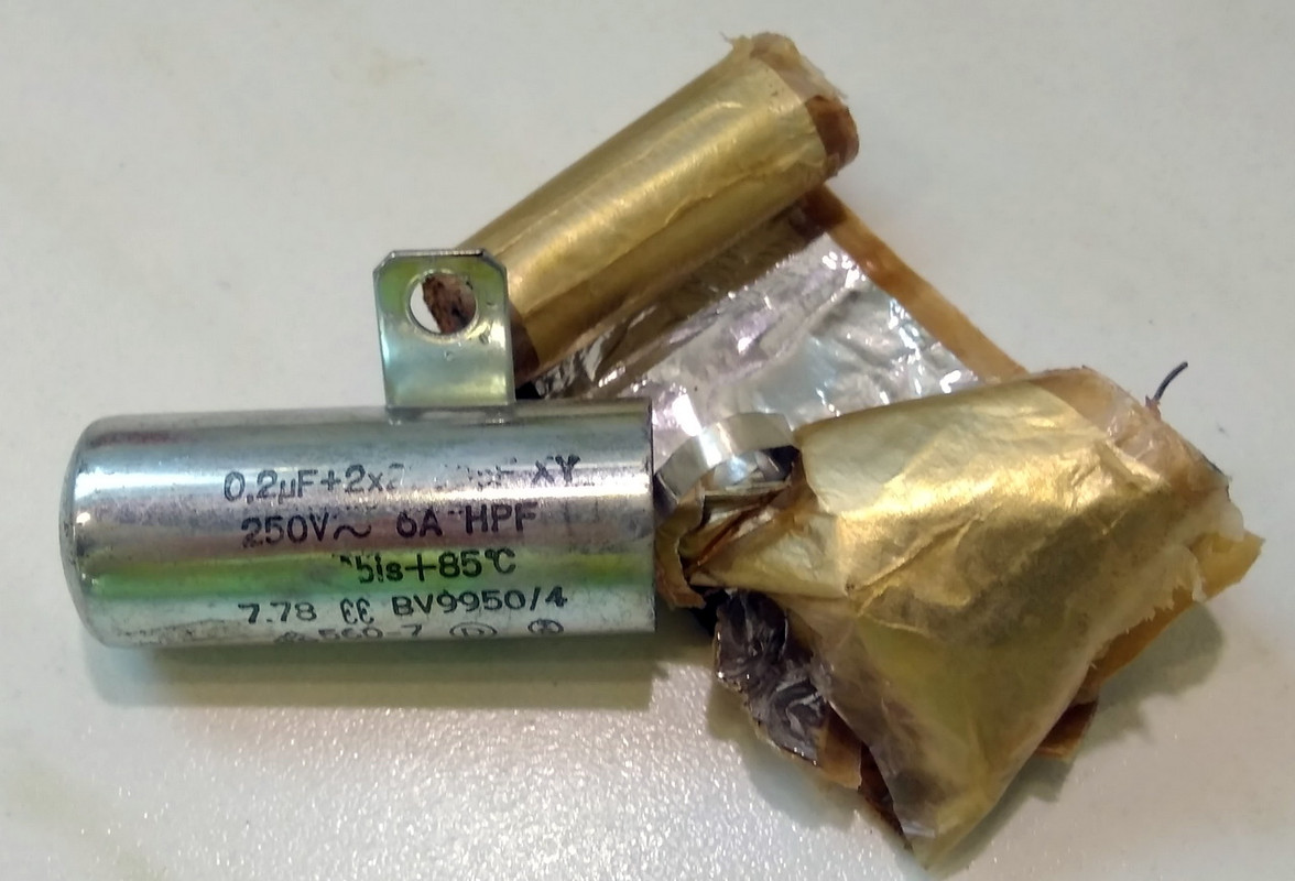

My vacuum cleaner died and it turns out that it was the mains cable with multiple
hidden cracks.  It was tricky to find it, because when I opened it I saw the following:
I have already bypassed the capacitor and the vacuum cleaner works again.
The cap had 4 wires.  Two blue and two black.  It was connected between live and neutral.
Its a 0.2uF and two 2400pF XY.
It says Y capacitor but the vacuum cleaner does not have a mains ground.
The capacitor case was bolted on the metal motor chassis.
Is it just a double capacitor in the same case for interference suppression ?
Hard to find and expensive.   Have you seen anything like that?
Can I just replace it with separate X and Y capacitors ?
Thanks.

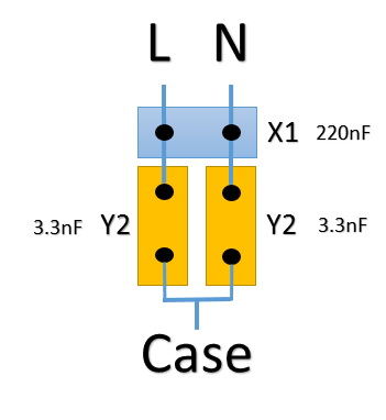

Offline wraper
  • Posts: 17952
  • Country: lv
Re: Interference Capacitor Substitution
« Reply #1 on: November 04, 2019, 01:40:18 pm »
It's one 0.2uF X capacitor + 2.2n Y capacitors. If you cannot find it in one package, you can replace it with 3 separate capacitors. Earth connection is not required to use Y capacitors. They can be connected to chassis without earth connection.

« Reply #2 on: November 04, 2019, 01:45:05 pm »
Perfect.
Thank you very much for the diagram!   :-+
What is the purpose of connecting the Y capacitors to the case, since its not earthed?
I do not understand how that works.
Offline wraper
  • Posts: 17952
  • Country: lv
« Reply #3 on: November 04, 2019, 01:52:36 pm »
Even without ground connection it helps reducing interference.

« Reply #9 on: November 04, 2019, 06:36:24 pm »
The capacitors couple the noise generating brushes to a faraday cage, formed by the motor metal. Thus the EMI is not going to be radiated from the long power wiring and cause interference. You can use 3 class Y capacitors in a triad, with them connected between line, neutral and the motor case, so that any RF noise will be attenuated, instead of radiating from the motor metal and the mains cord. You can use 3 10-47n class Y  275V capacitors there, typically a nice blue ceramic type, or a WIMA film type, your preference.
Vacuum cleaner has lasted well, 40 years in operation, check the brushes are not worn and arcing, which could have sent off the old suppression unit, though they do die of old age, as they are paper film capacitors, yours looks like ERO made, but you do get new replacements for them.

I see.
What do you mean connecting them in a triad?
Do you connect them like in the diagram above, but you replace the X with another Y ?

« Reply #12 on: November 04, 2019, 09:50:27 pm »
Yes, a capacitor between live neutral, live to earth and neutral to earth, will work.
By the way, did the capacitor failure cause either the live or neutral conductors to become in electrical contact with the motor chassis? If so, that's bad and should never happen. Y capacitors should fail safely, gradually reducing their capacitance over time, never shorting or blowing up. In this case it's probably not quite as dangerous, since the motor will already be in a plastic enclosure with and gears or belts, connecting to external moving parts, being made of non-conducting materials such as plastic or rubber.
