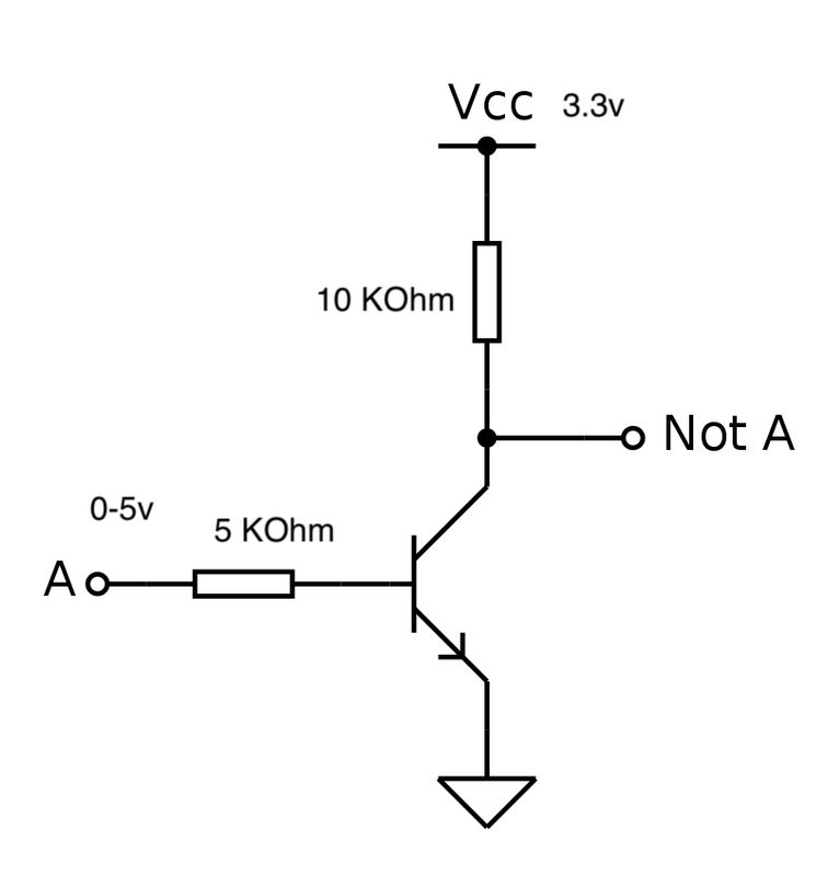

Hi Folks,
I have digital signal (0-5v) and I want to logically invert it and keep it in 3.3v for my microcontroller.
I made this circuit and seems to work. I used PN2222 transistor
The max frequency of the input signal is around 100Khz.
I believe that the transistor is in the saturation region when signal voltage is 5v and the transistor is in cut-off mode in case of signal voltage is 0v.
I am just worried about the V_ce saturation voltage since it will never reach zero volts.
I need your opinion if this circuit shall be stable and won't cause any issues... ex voltage spikes, ..etc

I don't really work with BJTs a whole lot (not as much as I should have), but if going into saturation mode is an issue, could you cut the base voltage in half so that it will go into forward-active mode? Though, for a logic application like this, perhaps saturation is the way to go.
That said, it doesn't seem like an issue at low voltages, especially with the 10k resistor limiting the current.

Whether it will cause "issues" depends on the rest of the circuit.
Whether Vcesat will cause a problem will depend on what the rest of the circuit is expecting. If it is a logic input, then compare the input's VIH and VIL with Vcesat and 3.3V. You'll probably be OK.
100kHz will probably be OK, but there will be some duty cycle distortion since the transistor will take longer to stop conducting (i.e. come out of saturation) than to start conducting. Whether that is an issue will depend on the rest of your circuit.

I am simulating with Arduino S.BUS protocol where the UART signal is inverted.

Increase the base resistor to 50...100 kohm, you're wasting current.
Yes, it'll saturate, but that's fine for 100 kHz. Expect no problems.
The CE saturation voltage will be around 50...100 mV. Ignore it.
All the above only applies if you're using a standard small-signal BJT, like BC847.

If you don't object to SMD/SMT you can also use a 74AHC1G04 inverter with a 3.3V supply.
