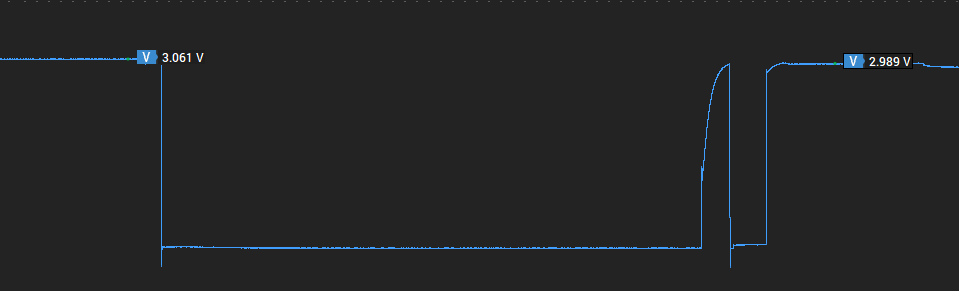

So I am banging my head against the keyboard now. I am trying to read a SWI EEPROM (AT21CS11) using PB7 of ATMEGA32U2. I have that line connected to VCC (3.3V) with a 2K
resistor. I am not sure what the problem is, but I have noticed that the reset and discover event does not look correct.
The RESET and DISCOVER event should look like this: PB7_LOW, wait 200uS, PB7_Release, wait 10uS, PB7_LOW, wait 1uS and release, then check if bus is being pulled down by AT21.
Here is what the correct waveform looks like:

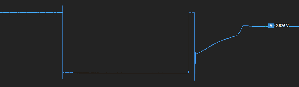

However, here is what mine looks like:
Does anyone have any ideas of what I did wrong?
