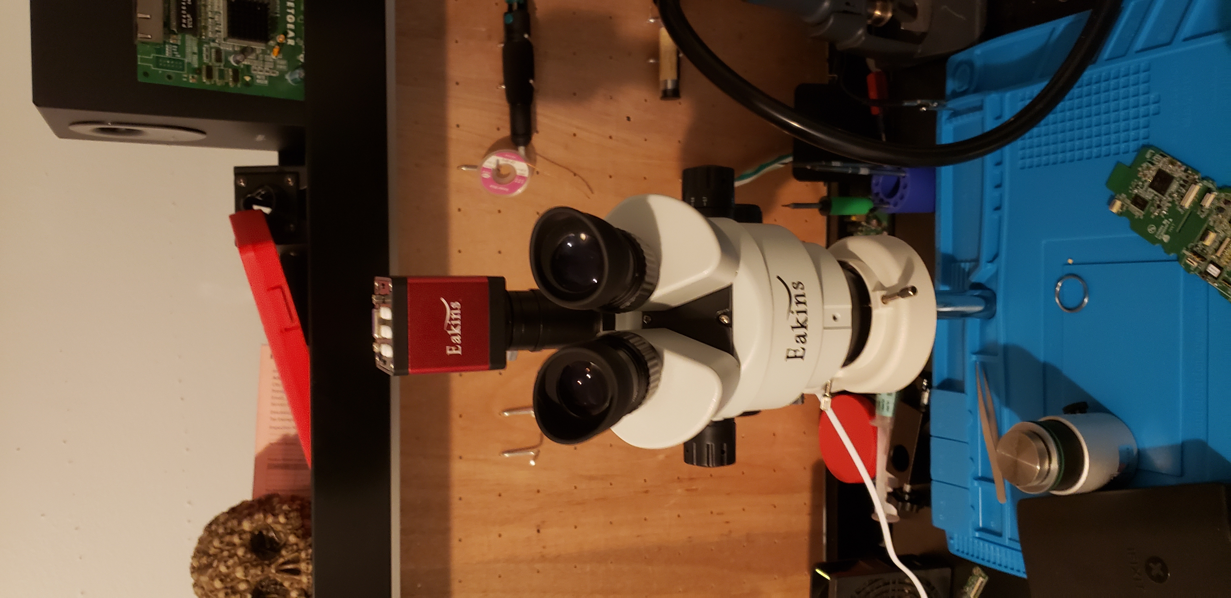

So my first microscope came in, I bought a Eakins Trinocular microscope, but I'm having issues with my eye pieces.  When I look through them it's mostly black.  What am I doing wrong or is it the microscope?

Offline Kfire778Topic starter
  • Posts: 15
Re: Issues with my first microscope
« Reply #2 on: March 30, 2019, 08:58:02 pm »
This might sound weird, but the closer I get the less I can see, farther back I go more I can see.

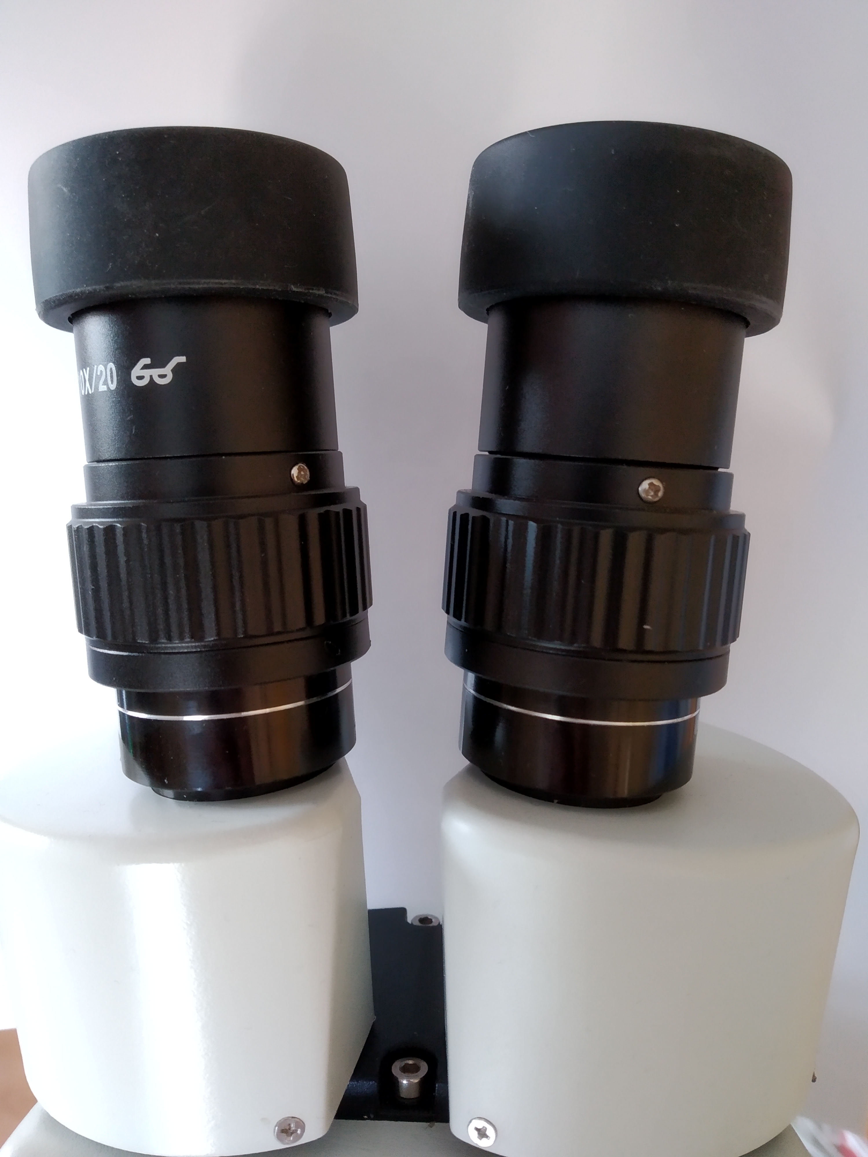

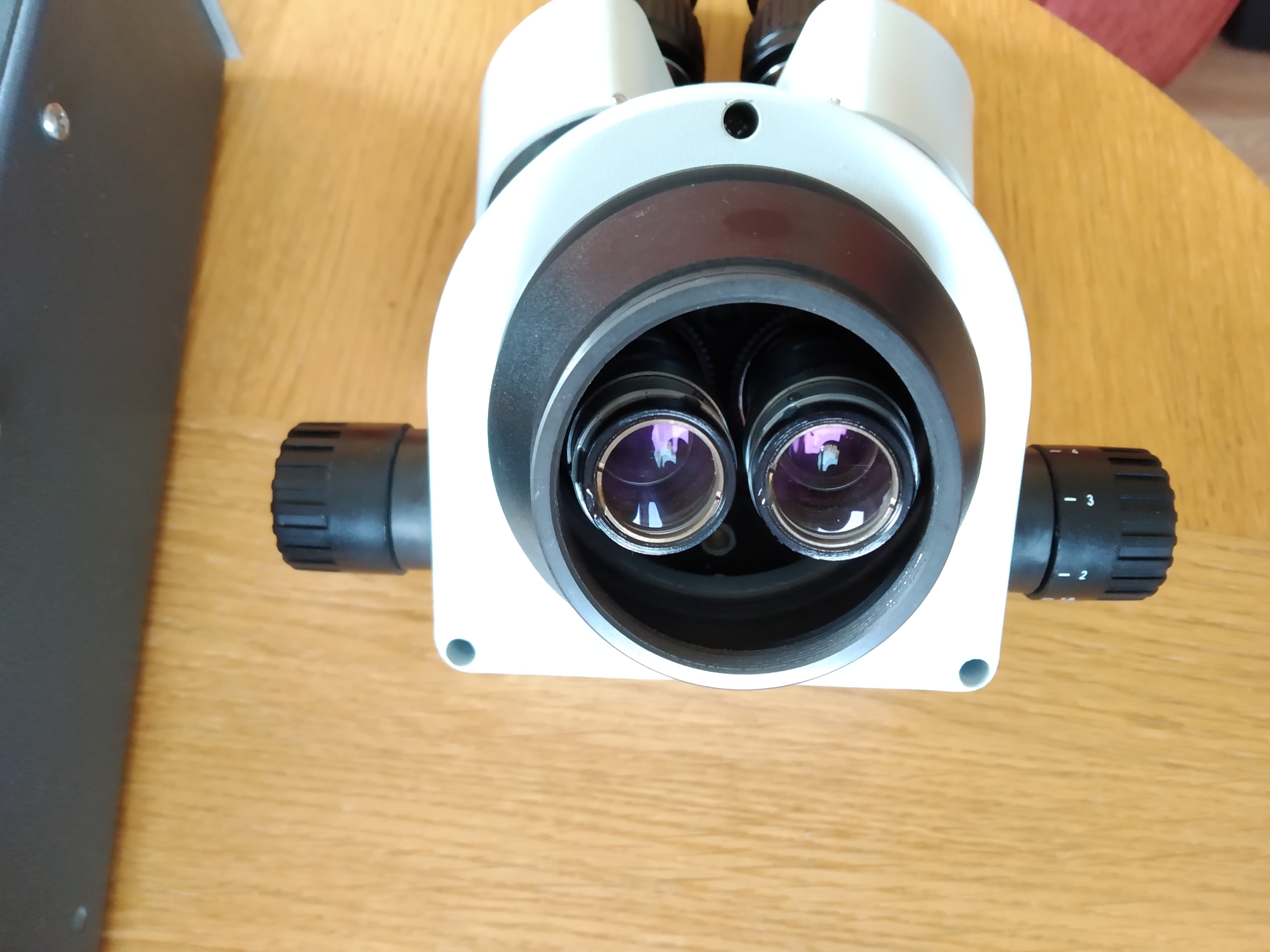

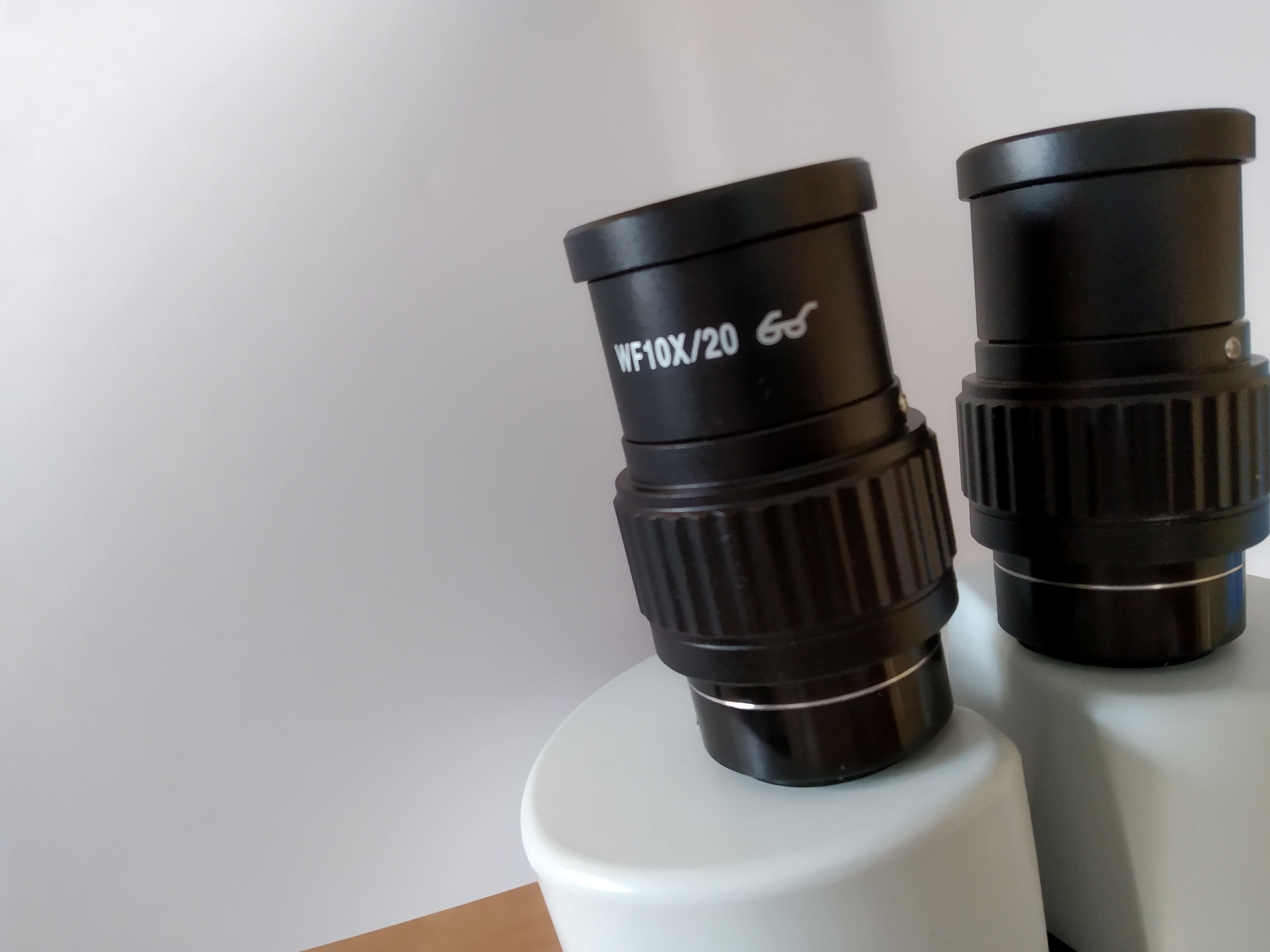

« Reply #19 on: April 03, 2019, 12:01:12 pm »
Kfire778 sent me these two images to post for him here.
  Lord of Sealand

  • Country: ua
« Reply #20 on: April 03, 2019, 12:08:58 pm »
If you don't have bad eyesight, the adjustment for both eyepieces should be the same.
Here is how much I have to adjust mine:
Are both eyepieces the same? Mine are both Wide Field 10X/20mm
  Lord of Sealand
Offline grizewald
  • Posts: 612
  • Country: ua
« Reply #21 on: April 03, 2019, 12:18:37 pm »
If you swap the positions of the eyepieces, does the problem move with the eyepiece?
Have you checked to make sure that the objective lenses on the bottom of the microscope head are both screwed in properly?

Offline jfiresto
  • Posts: 896
« Reply #24 on: April 03, 2019, 03:16:44 pm »
Thanks, guys, for the pictures of the microscope. It appears to be a Greenough design with a fixed tube length. I may have to keep quiet as the microscopes I know best are Common Main Objective with infinity optics. I do have a Greenough, but it is a nearly indestructable student model that discourages students from taking it apart. Which is probably good, as back then I would have, to see how it works.  :)
