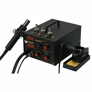

« Reply #5 on: January 09, 2022, 05:09:14 pm »
I have a Hot Air Pencil 852Dplus but can't find it anymore (https://s.alicdn.com/@sc04/kf/HTB1nNEBXPDuK1RjSszdq6xGLpXaK.jpg_300x300.jpg).
I've used it about ten times and think it's great.
One thing to remember is not to bang it down hard when it's hot because the thin heater elements can crack. Hot air guns and this pencil I always set down very soft and let it cool before putting them away.
The ONLY issue with hot air pencils I've experienced: when trying to remove an IC (or a component) where you need two hands to tinker with removing/placing the IC should it fall out of place, you run out of hands to also hold the hot air pencil.
I'd like to print a 3D bracket that has a rack and pinion allowing me to mount the hot air pencil and move it up and down to pull away the heat allowing me to handle the hot component.
I found something on Thingiverse, but believe it's not for a hot air pencil. I'm uncertain of the size, so I never printed it; or really bothered to address the need for it since I seldom use the pencil.

It's an utter trash Compared to Quick and Atten ST-862D. Fan it the handle by itself means it's not good. Half of the power, 20% of the max airflow. Not to say such stations have problems with airflow stability on low setting, and vibrate in the hand.
It's an outdated station with a membrane pump. Not even close in performance to Quick and Atten mentioned.
« Last Edit: January 09, 2022, 05:29:10 pm by wraper »
