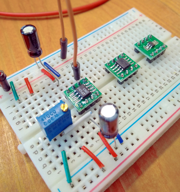

I am having a problem with an LDO I bought from TME.  It is supposed to be capable of 1.5A
but I cannot get it to supply more than 100mA.  My input voltage is 4.2V and the output voltage
setup by a resistor divider at the ADJ pin of the LDO is 2.6V  The resistor values are R1 = 892Ω,
R2 = 1040Ω and it outputs a stable 2.6V, which is what the ADJ pin formula gives as well.
The reference voltage is 1.21V as it is supposed to be.
https://www.analog.com/media/en/technical-documentation/data-sheets/1963fc.pdf
When I connect a load to its output, a 3W LED in this case, it outputs from 70mA up to 100mA and
the voltage drops down to 1.9V-2.0V  Power supply is set with a current limit of 600mA.  The LED
when connected to 2.6V directly from the power supply draws 650mA.
I have used low ESR output capacitors either a 10uF or 330uF 40mΩ, but nothing changes.
What am I doing wrong  :-//
Probably I am doing something stupid but I cannot find the cause.
Any help would be appreciated.
Thanks.

My first guess would be that you have some vdrop in your wires or connectors.
As the current increases the input voltage drops and prevents any higher current from flowing.
Connect up the LDO so it should be powering the LED at full power but isn't.
Then measure what voltage across the lab psu at the lab psu's terminals compared to the voltage at the pins of your LDO.
You may find that your LDO is not getting the voltage you think it is.
Breadboards are notorious for bad connections

The IC is stone cold.
Psi I think you are right.  I moved the output ground jumper wire to a different place and I got 240mA
and a 2.1V output.  Still not there, but it seems that I have a faulty chinesium breadboard...
I will try right now a different one and see what happens.

I've just tried a second breadboard and I got to 315mA but no higher.
Maximum temperature of the IC was 40 degrees C.
If I press on the jumper wires it goes a bit higher.
Especially on the ground wire.
So, it looks like that the problem lies with the breadboards.
But I get half the current current that the LED normally draws.
What do you think?

It may also be oscillating with the capacitors so far away.  Move the capacitor connections to a spot immediately adjacent to the regulator or even solder them onto the interposer.

I've managed to get 800mA.  Its the breadboard.  Genuine Chiniseum.
The trace on the oscilloscope is completely flat with non existent ripple or spikes even in the 2mV range.
