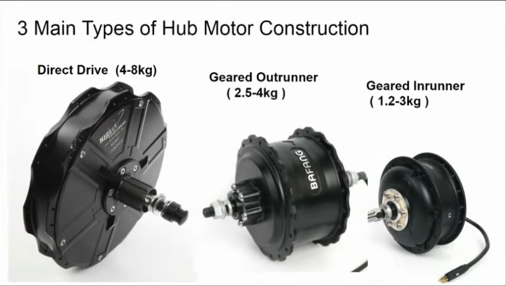

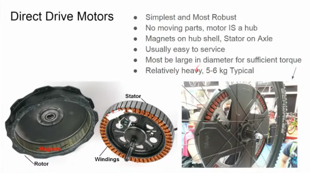

I want to build my own stator from highly accessible and cheap parts (bolts, brake rotor, etc).
If I build a mid size motor and use extremely overpowered, extra-large magnets what would happen? I have around 10x 1"x0.25" circular neodymium magnets - if I buy 10 more would that be enough to build a crazy powerful motor?
Direct drive hub motors are the old style and don't have the planetary gearbox, it's less torque but still very functional. Was watching this video last night, some boring parts but over all very solid:
I have a 3d printer (been procrastinating fixing it for around 2 months now)... nlyon plastic gears should work for building a planetary. I already have the CAD files for lots of planetary gearsets. Just want to keep things super simple though, so direct drive.

This is more of a mechanical, than electronics problem.
It's extremely difficult to do. How are you going to secure the magnets, so they don't stick to the stator?
A very tight clearance between the coils and the magnets is required to achieve good efficiency.
Nylon is fine for cogs which aren't subject to much torque, but no good for high torque applications. Quite often nylon is used for the gears nearest to the motor and steel, at the load side.
