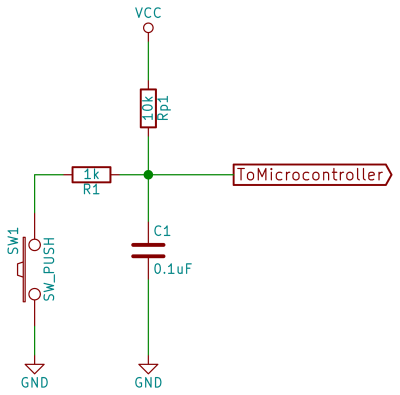

What I use is a simple circuit found on hackaday (https://hackaday.com/2015/12/09/embed-with-elliot-debounce-your-noisy-buttons-part-i/)
I really like this circuit for 3 reasons, its got hardware debounce (less code), its simple, and there is a series resistor on the switch, so any HV transients will be reduced before hitting the GPIO.
(Some MCU's can have ESD protection built into the IC's GPIO)
See page 1 https://www.st.com/resource/en/application_note/an5612-esd-protection-of-stm32-mcus-and-mpus-stmicroelectronics.pdf
