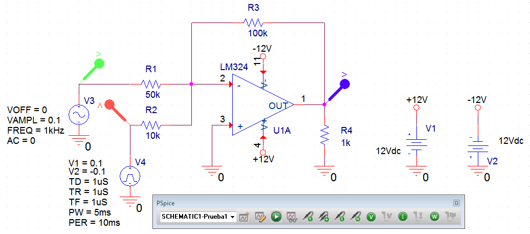

My install of LTSpice IV doesn't show the actual voltage probes on the schematic after running the simulation. It plots it out but the actual markers don't show up on the schematic. I can't seem to find an option for this and no mention in LT literature. It would be a nice feature to have.
Is this a bug and can anyone help me squash it?

I don't think there are any visible probes in ltspice. The traces shows the nodenames ("V(n001)" etc.) which I agree is not terribly handy...

Dago, I guess that would settle it. I was looking for indicators like the ones in OrCAD Pspice (http://www.alciro.org/images/alciro/1208_pspice-sondas-de-se%C3%B1al.png). I just assumed they would be there... whatever, just an inconvenience and the price is right!
