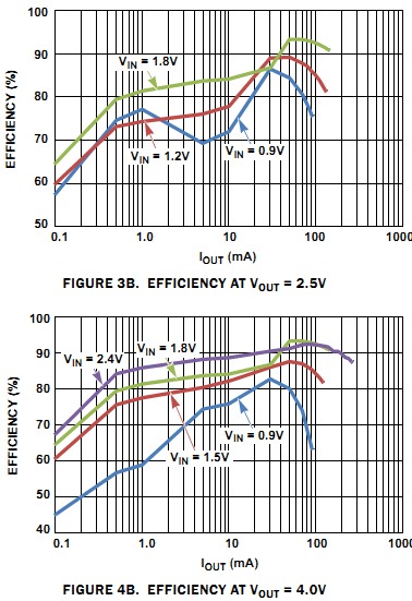

I've bookmarked ISL9111 for a project of mine :  http://www.intersil.com/content/dam/Intersil/documents/fn76/fn7602.pdf
20uA quiescent current, up to 95% efficiency at 5v output with a 3.6v input.
There's another graph there showing 2.5v and 4v output :
Wouldn't it be more or about as much efficient to do 2 x 1.2v AA batteries -> 3.3v instead of converting 3.6-6v to 3.3v with linear regulators?
Just wondering... didn't do the math...

350F sounds like a huge value. How did you come to that value? (later edit: Oh, I just selected in digikey anything above 300F and that capacitor was the cheapest so I guess maybe that's how)
This boost regulator I had in mind is already capable of generating directly 3.3v but with a voltage input close to this value (2.4v or more) at a few mA output it has a high ripple of up to 100mV.
I was thinking that as the current draw of the device  is about 1mA, the boost regulator would be inefficient, at about a 65-70%. So I would use the super capacitor simply as a buffer of energy, to pump current into it at 100-200mA (the peak efficiency of such ISL9111) then turn it off until the super capacitor is going down to 3.5v or whereabouts.
There are LDOs with 10-100mA maximum current which have about 0.1v drop, maybe even less at 1 mA draw... for example MC78LC33NT ( http://www.farnell.com/datasheets/87792.pdf ) drops 30mV at 1mA.
