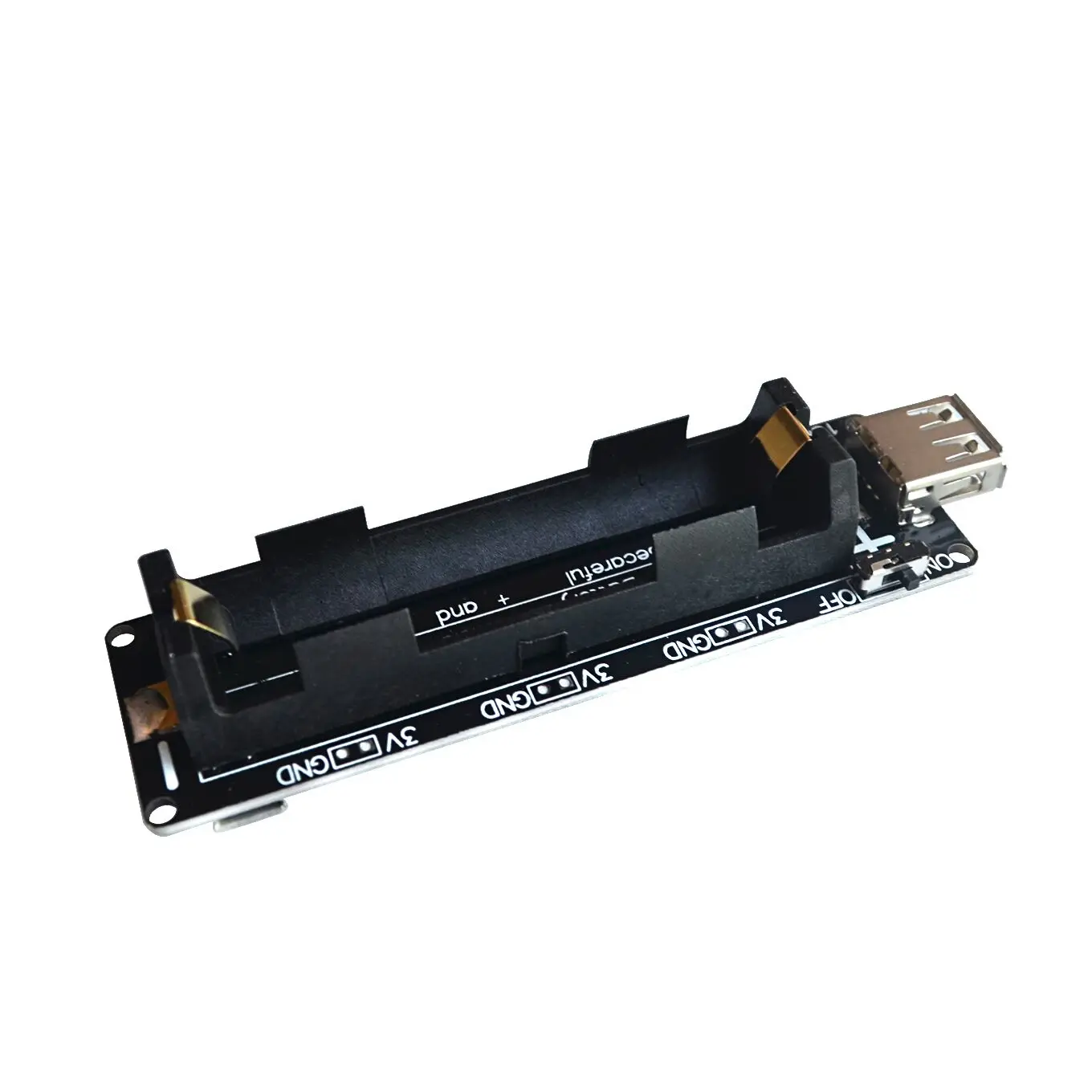

beanflying, interesting module, will order couple.
