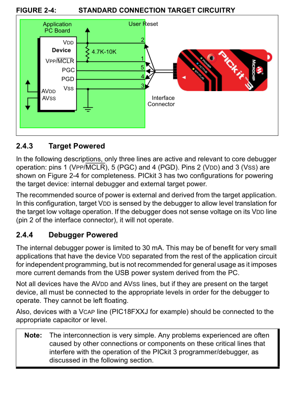

As for a circuit... no, there's not really any circuit, it's nothing complex.  Just a resistor to keep the reset line high and give the pickit the ability to restart your pic chip and that's all.
The resistor doesn't even have to be 10k, it just has to be a reasonable value, the guide says 4.7-10k.
See Pickit 3 user guide :
The wires are numbered from 1 to 5, 1 is the pin marked on the pickit 3. The black triangles go to the input voltage that you use to power the chip (up to about 5.5v). AVdd and Avss are only required on some controllers.
