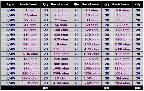

64 values 1280pcs 1 ohm - 10M ohm 1/4W Metal Film Resistors  Assortment Kit: https://www.ebay.com/itm/64-values-1280pcs-1-ohm-10M-ohm-1-4W-Metal-Film-Resistors-Assortment-Kit/261374861457
This comes with 20 resistors of each ranging from 1 ohm to 10M ohm: https://i.ebayimg.com/images/g/79UAAOSwySlZ-uUL/s-l500.jpg
