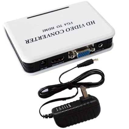

Online Ian.M
  • Posts: 13076
Re: Simple VGA to YPbPr cable? or decieved masses?
« Reply #8 on: April 05, 2015, 01:51:14 am »
The display's component input may not support any resolution or frame rate the laptop's video card can output even with an active converter in between.
The Amazon link says the display has HDMI.
If the laptop is old to the point of obsolescence, I suspect a USB HDMI second display adapter is not a particularly good idea (driver compatibility and system stability) and I expect a VGA to HDMI converter box would have the best chance of working.

Ian, I searched ebay for VGA to HDMI converter box and found http://www.ebay.com/itm/1080P-Audio-VGA-to-HDMI-HD-HDTV-Video-Converter-Box-Adapter-for-PC-Laptop-DVD-US-/181306560583 what you mentioned - China does it again! GeeWhiz! And at $16.39, it's a price my friend can handle!

« Reply #12 on: April 05, 2015, 02:37:28 am »
Thanks guys, I guess I've done enough fruitless soldering. Now I can save my capacitors for something that will actually function  :)
I supply the cables and for under $20 there's a useful, multipurpose, hardware-only solution with better quality video and audio too.

« Reply #13 on: April 05, 2015, 06:40:01 pm »
A final note to those who are "ebay-shy" and would like this "piece of kit" - I found it for $17.68 at Amazon:
http://www.amazon.com/1080P-Audio-Converter-Adapter-Laptop/dp/B00K3OJPZO
