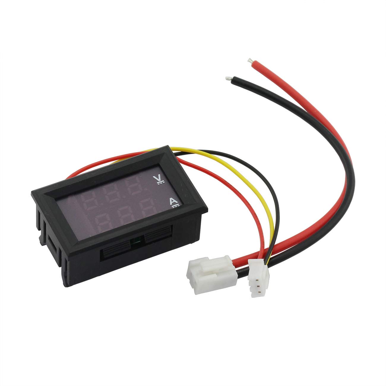

Offline Richard Crowley
  • Posts: 4321
  • KJ7YLK
Re: Need trouble shooting help (pics)
« Reply #33 on: February 23, 2019, 10:38:35 pm »
...discharge the transistor with my fingers...
Transistors do not "hold a charge" like that. Certainly not for low-voltage DC circuits such as yours.
Your power sources are "black boxes" that are not behaving like you imagine they should.
Even one of those $10 volt/amp panel meter things would show you what voltages and currents you are really dealing with.  For example...
https://www.amazon.com/ZRM-Digital-Voltmeter-Ammeter-Display/dp/B07DZTPSLS
