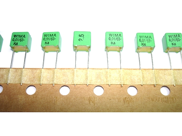

Current leakage value in uA units does not make sense as region of interest/danger lies in mA region. Also regarding:
You should be sticking to standard SI / Engineering notation (even more so for beginners). We don't talk about 0.25M resistors, we say 250k. We don't use 0.25kV when we mean 250V etc.
250uA is the appropriate notation in this case.
Why engineers are using 0.1uF capacitors for decoupling? And 0.1uF naming is mentioned more often used than 100nF. BTW it's even more common for markings on capacitors. I'm sure that you definitely should tell engineers and manufacturers that all of them are wrong. And for sure you should tell to those who made that 0.05 ohm resistor instead of 50 mohm, they they are complete idiots.
« Last Edit: August 30, 2017, 11:50:34 pm by wraper »
Offline Gyro
  • Posts: 10174
Who knows  :-// Historical reasons? I guess only the manufacturers could have an answer for that.  I could pull out an equal number of caps from my parts box that use the correct notation, those that don't use IEC notation of course. At least the US maufacturers seem to have stopped using mF when they mean uF. It's certainly something you don't want people littering new schematics with.
The above is no excuse for us not using and promoting correct engineering notation here though, particularly for fundamentals like voltage and current.
P.S. I see 100nF used a lot more than 0.1uF in discussion and schematics, I certainly don't see 0.01uF used instead of 10nF these days (as used to be common in the past). maybe a geographical thing.

  • Posts: 23099
I noticed this. Americans historically used mmf and mf as measurements of capacitors (pF and uF) only and half the time they don't even add the units. This seems to have turned into a defacto standard in American literature. Then you have to decipher whether "47" means 47pF or 47uF. Here in Europe we adopted all of the correct symbols: F, mF, uF, nF, pF.    47u, 47p. Problem solved. Ultimately there should be no leading decimal portion of the number - just use the correct units!
Again diversion off :)
