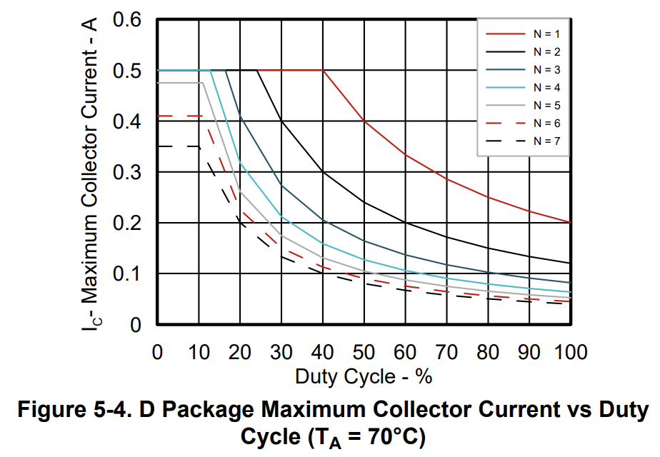

I checked the datasheet to see figure 5-4 and figure 5-5.
My concern that with increasing dutycycle for 7 channels, the output current goes down!!
in case of duty cycle equal to 80%, 90 and 100%, each channel can deliver only 50mA which is low in my opinion.
I also noticed in figure 5-1 and figure 5-2, that V_ce will 1v @200mA. This mean the power delivered to the servo motors will decrease.
did I understand the datasheet correctly or I overlooked something ?
Yes, total power dissipated by the capsule is not enough for all 8 transistor fully ON.  And at 3.3V you will lose considerable voltage (and power) percent because of the Vce sat of ULN2003.
I would look for a driver with MOSFET transistors instead of BJT.  MOSFETs can easily achieve miliohms Rds when fully ON.  You need low Vgt MOSFETs that can fully turn on at Vg less than 3.3V (sometimes these are called "digital" MOSFET).

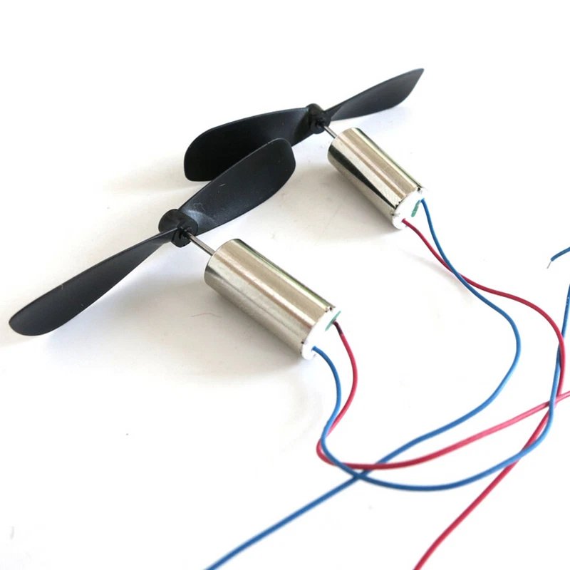

But since I opened the topic. I would still be interested for a solution for Leds or small DC motors. something like this:
If I use all channels of ULN2003A. it still will not provide that much current.
