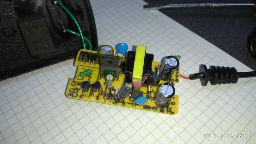

Maybe watching Big Clive's videos has made me a bit paranoid, but without breaking them apart, how would I know what constitutes a "good" or "safe" AC to DC adapter?

At a small fraction of the price, its *very* unlikely to be better.   The way to bet is its worse, but without tearing one apart, you cant tell if its so bad its actually unsafe.

For small quantities, paying the premium for a reasonably reputable brand from an authorised distributor is the only safe choice.  The liability from a single incident could wipe you out if you go for a cheap Chinese import.  If you need multi-K quantities there are other options . . . .

I mean, this is just for my projects, but there's got to be a middle ground between $5 supplies and $40 supplies.
Found some interesting things while looking at some of the "popular" AliExpress listings
* Weighing the power supply in comparison with others seems to be a thing
* Even on what looks like a good listing, there's review photos like https://ae01.alicdn.com/kf/UTB8A5rOxVfFXKJk43Otq6xIPFXak.jpg
... on second thoughts, I'll pay $40.

There are some reputable brands, like Delta, Lite-on, and Ault, that you can expect not to fail from inadequate isolation or saturation.
But you should consider that in any power brick with a linear regulator, it can short out and let unregulated power to the output. This means that the maximum voltage from a 9V DC regulated supply can actually be 15V, etc. Hopefully your equipment can withstand this without blowing up, and you will remember to test the power supply when something goes wrong instead of blaming something else.
