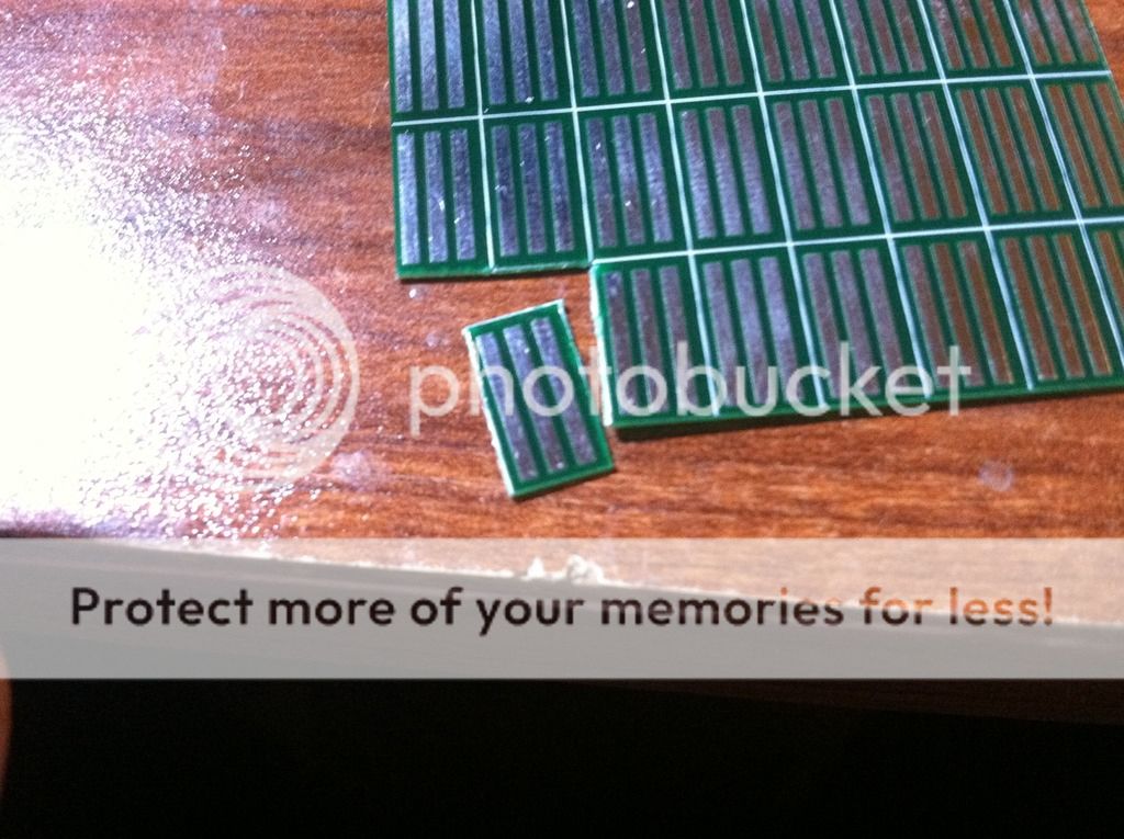

Nice, good price.  Do they offer drill holes so I can snap off parts of the board?  I want to make it like the picture below.  This board is actually cut so only a few fiberglass layers are left allowing it to snap off.  Is there any setting in kicad for that?
No EDA package supports that directly; unfortunately there's nothing in the Gerber spec for something like that. Those are done by placing lines on the mechanical layer to indicate where you want the scoring, and labelling them to indicate that. It's generally something you only do when you have a whole panel made, and will generally require some communication with the fab to make sure that your labelling isn't missed.

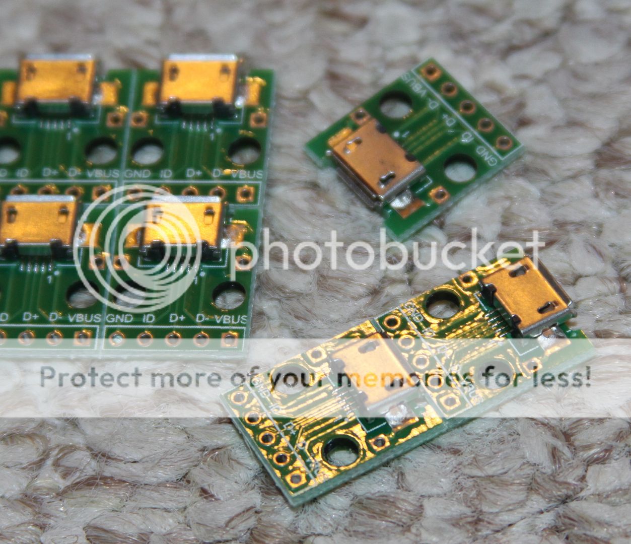

Hackvana got me what I needed!  .8mm and v-cut for every piece!  Awesome guys over there, check them out!

Turns out like all other pcb houses I could not get v-cuts on such small parts, he tried a bunch of places but the only one that would do it wanted an extra large fee.  I just ordered it without c-cuts and .8mm.  Works great just snipping the pieces off with my wire snips and was really inexpensive.
