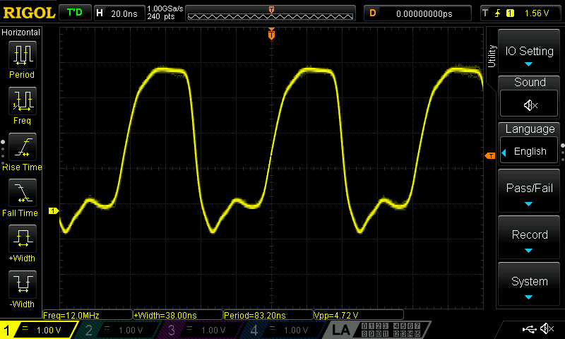

Have it hooked up to a scope.
I can see 12Mhz on C12 both legs and same at C13. Also same for R43 and R45, both legs.
R44 has one side with no signal. Presumably thats because it connects to GND?
Pins on the LS04 that are listed on schematic, show 12Mhz.
Curious as to why all other ceramic caps on the board show a HI and LO and this showed LO on the logic probe.

Probe pin 12 of 2N and look for a square wave.  If you get one... it works and consider the actual oscillator as a magic black box.
Probing inside the oscillator is prone to issues where the capacitance of your leads/test equipment etc will cause odd behaviour.
The output on pin 12 should look squareish... again your test equipment will affect what you actually see... square-ish is probably enough.
If you are interested.... http://www.z80.info/uexosc.htm  Yours looks like the 2nd example.

Pin12 3N, square'ish wave at 12Mhz. So that's fine. See below
